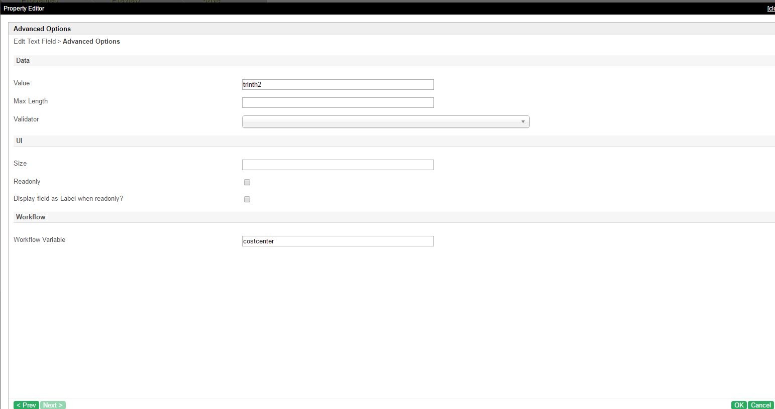

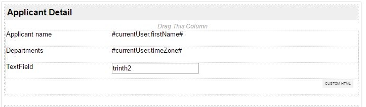

  1. Applicant Detail:
    In the Textfield, I defined value is the userID trinth2
  2.  and workflow variable is costcenter

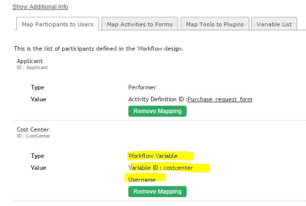

  3. In the Map participants to User: I selected as seen in the picture below:
    But in workflow do not go to the userID that I mentioned in the first form.
    Please advise how to fix this issue.?

      Hi Thang
      The best way to learn is to explore and 'take apart' a working app that is using workflow variables in "Map to Participants" to see how it works.
      Do download and explore the app "Approve Via Email".
      The Account Creation App also has an example using beanshell in the "Map to Participants".
      Open up the process "Test Approval Via Email" to view.
