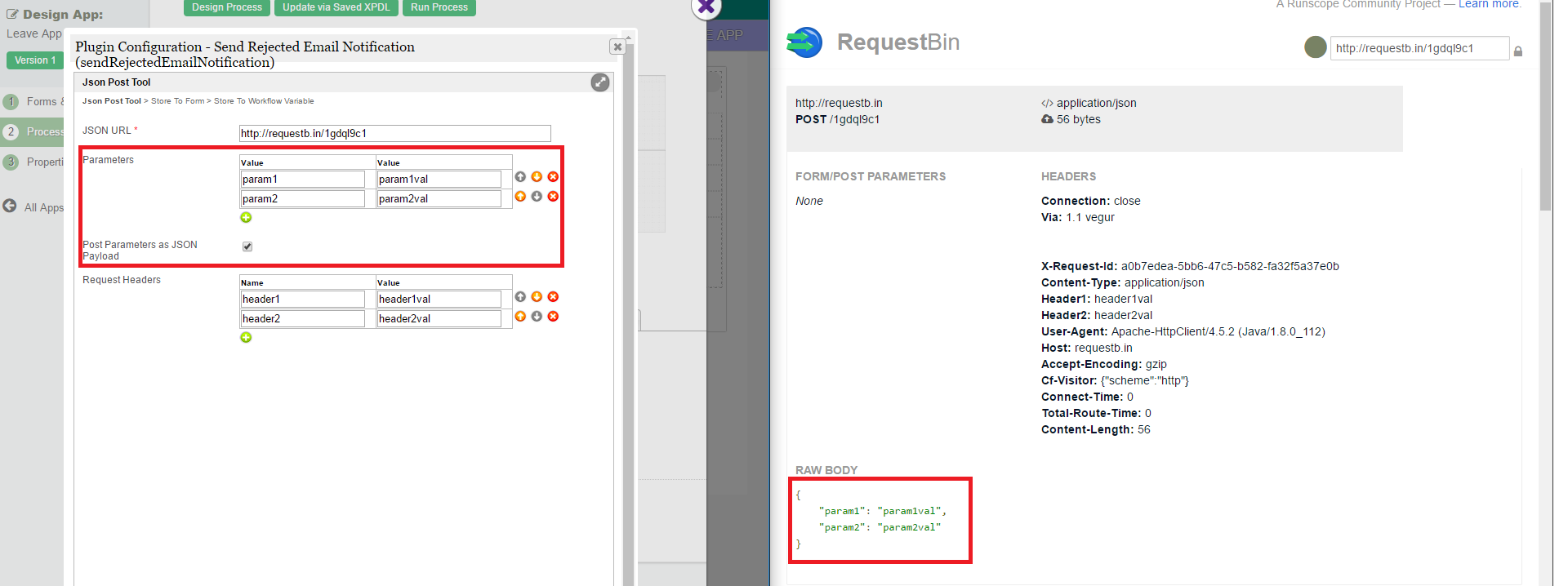

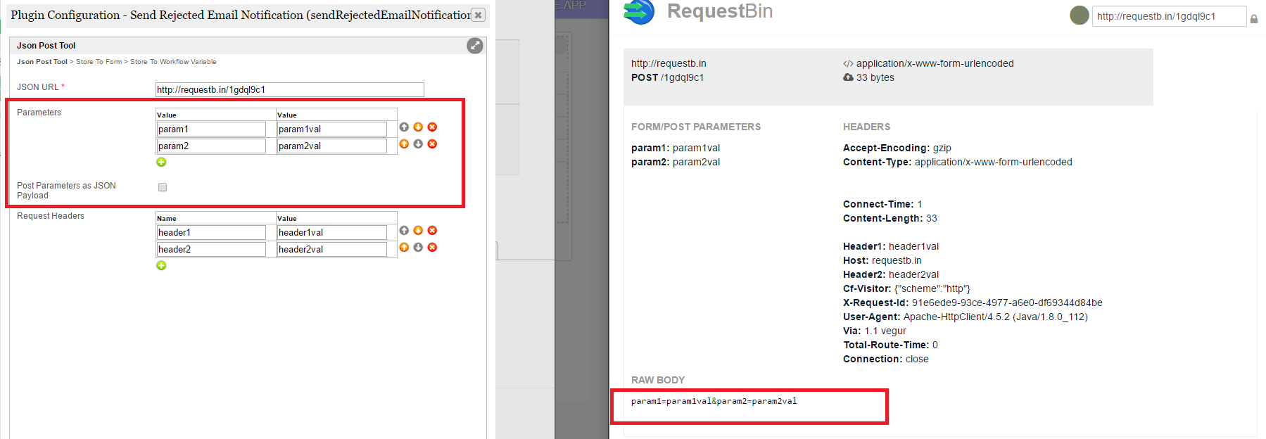

Hi Eric,
I tried to replicate what you said but it worked as expected. Please see the screenshots.
Let us know if you can find anything.
Thanks in advance!

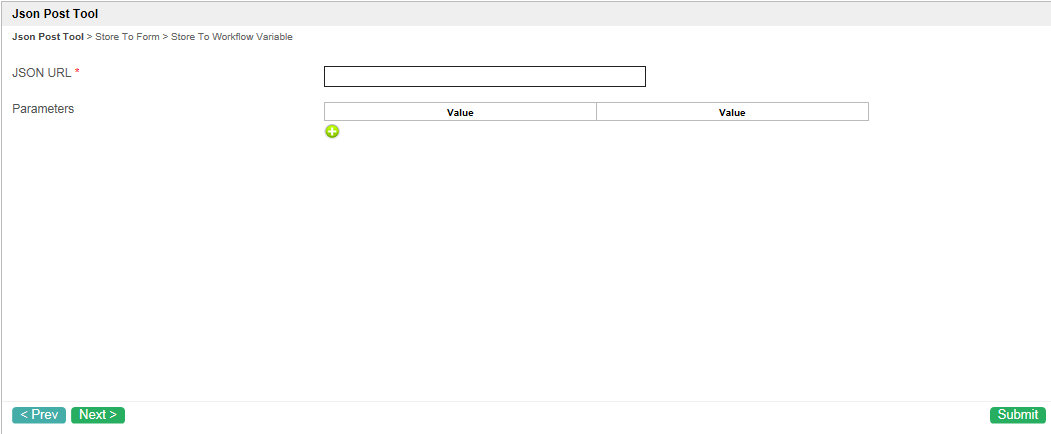

Hi guys,
I just wanted to make use of the JSON Post Plugin (to authorise and get data from a JSON feed - not to post a payload).
However, unlike the original screenshot in the Joget Marketplace, the actual screenshot of the plugin looks like this and does not have Request Headers parameters:
I know that the payload plugin in the marketplace has the Request Headers.
Could you please add this part of the plugin to the JSON Post Plugin so that one can authorise the request against JSON APIs?
Or am I missing something?
Many thanks and kind regards,
Eric
