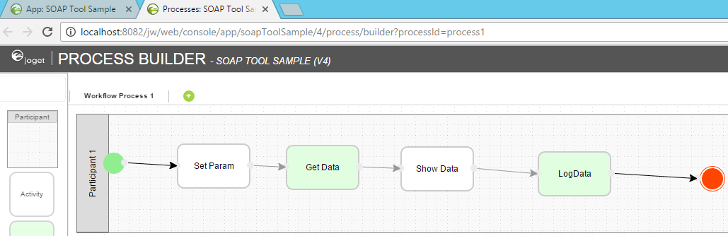

I have used the SOAP Tool sample app (using the airport service), and added a tool event (LogData), after the "Show Data" activity as per screenshot below:

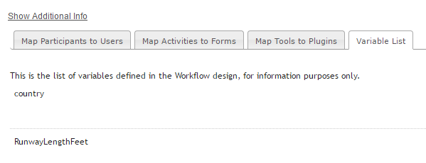

I have added a workflow variable "RunwayLengthFeet"

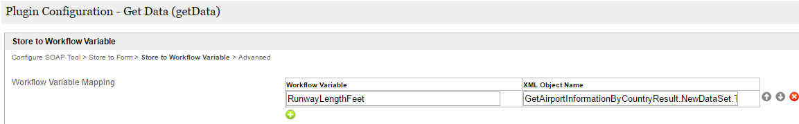

I have mapped this workflow variable ("RunwayLengthFeet") to the XML object name "GetAirportInformationByCountryResult.NewDataSet.Table.RunwayLengthFeet" in the SOAP Tool as per the screenshot below:

      As Bastiana mentioned, you can only store a single value to the workflow variable. Looking at the SOAP call, the response is an array, so you can try using an index in the XML Object Name to reference the first element e.g.
      GetAirportInformationByCountryResult.NewDataSet.Table[0].RunwayLengthFeet

      "Store to Workflow Variable" tab only expect one singular object value, it will not loop through multirow data of your airports.
      It is not the same like iteration based support under "Store to Form" where it loops through and store multiple records in form data table.
