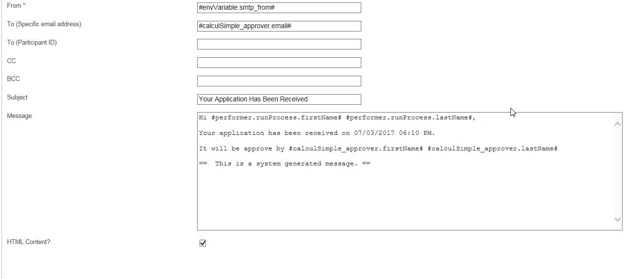

Hi, what I am trying to do, is to get the user that is suppose to complet the approvement. Exemple: I want to approve something, and the approver is #calcuSimple_approver# which I mapped to the admin. I want to specified the email of #calcuSimple_approver# because, if I want to change the user mapped to #calcuSimple_approve# I also want the email tool to change automaticly. Thank you

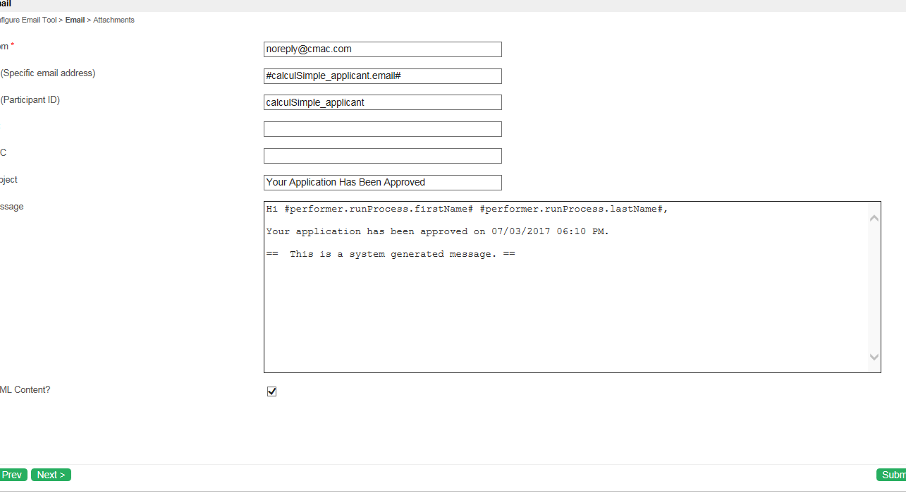

I don't understand why this is working then. See the other reponse please. My email is recognize when I call the applicant, but isn't when I call the approver. I don't understrand. Thank you

Instead of setting the specific email address, you can try just setting the To (Participant ID) to the participant ie calcuSimple_approver. That should send the email to the user mapped to that participant.
as you can see i try to send a email to the approver but i don't understand why the information(email, firstname, lastname) of the approver isn't avaible... May someone help me to understand why this is happening? Thank you.

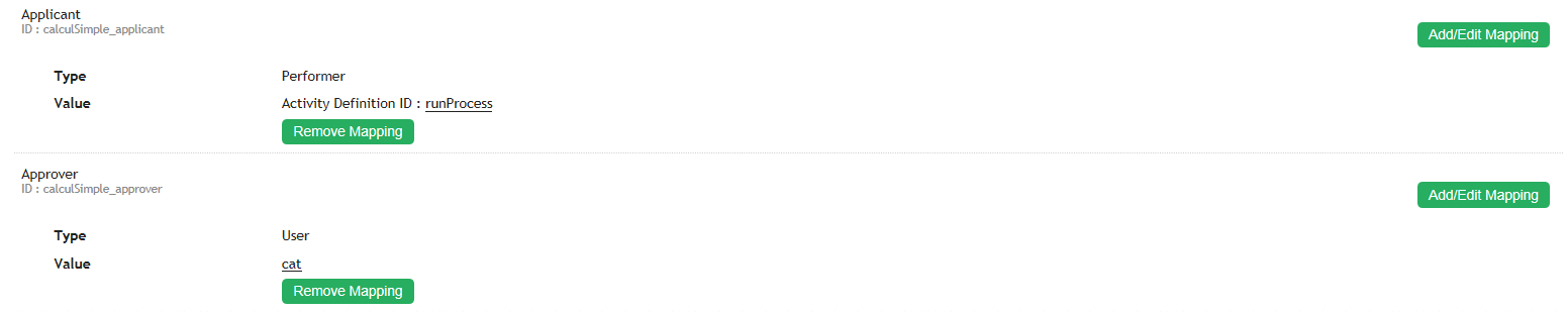

Here's my approver value:

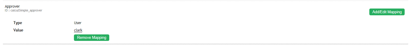

Here's the approver "Clark Kent"
