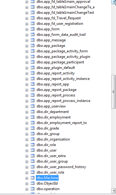

Hi Matthew, since it's a table I have create from sql management, the name of it won't be app_fd_Machine. should I rename the table to app_fd_Machine ? Thank you very much.

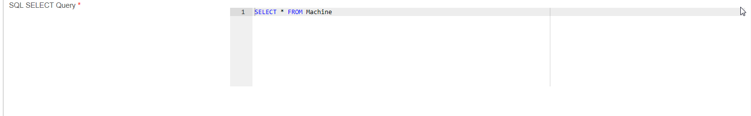

Here's my query:

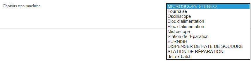

Here's the 10 results of the query in joget:

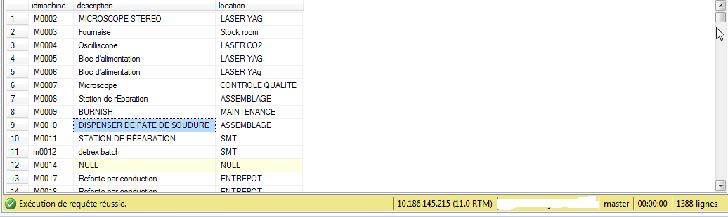

Here's the results of the same query from sql management:
