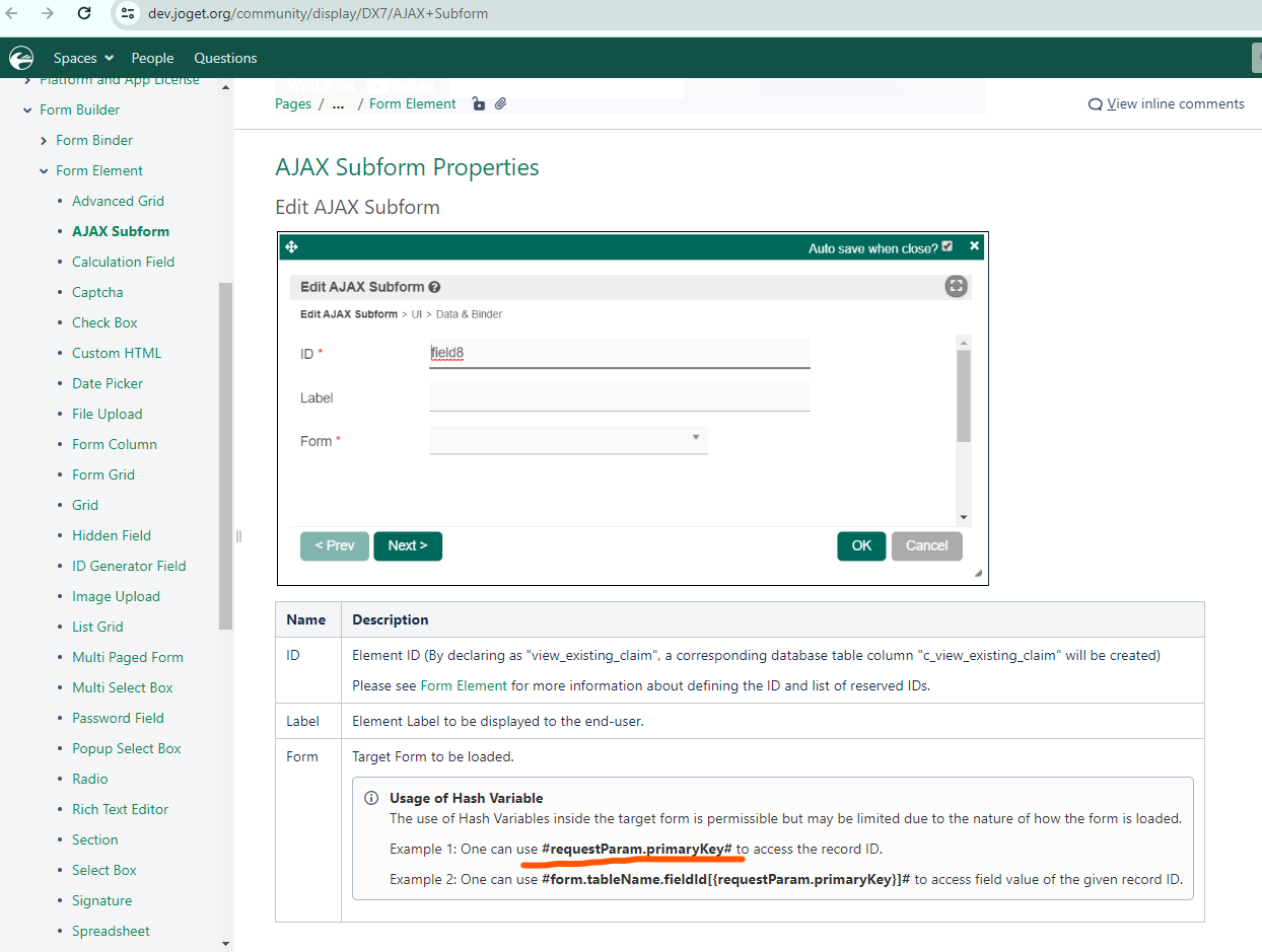

It is a bit hard to understand your question. Where are you going to use the hash? Is it inside SQL in the form used by ajax subform? Then you can try "#requestParam.primaryKey#"
Hello Expert, i want to build Hash Variable Plugin to return a String Query for Form Grid Load Binder which the Form Grid is inside Ajax Subform and i need the RecordId for where clause query. I've try hash requestParam.id and hash form but every time Ajax Subform Loaded trigger because there are change on Parent Field Value for Ajax Subform Data Linkage the hash value is id field ajax it self for hash requestParam and for hash form is null.
