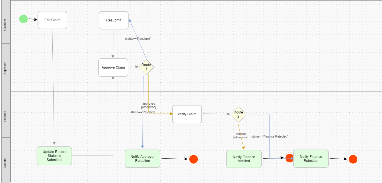

i want to send email notification to the claimant when his/her form is approved, rejected or resubmitted.
i want to send email notification to the finance as approver approves or reject the form.
i want to send email notification to the claimant and approver, once the finance verify the claim.
how can i do so. please guide me the solution. as the process is below:
