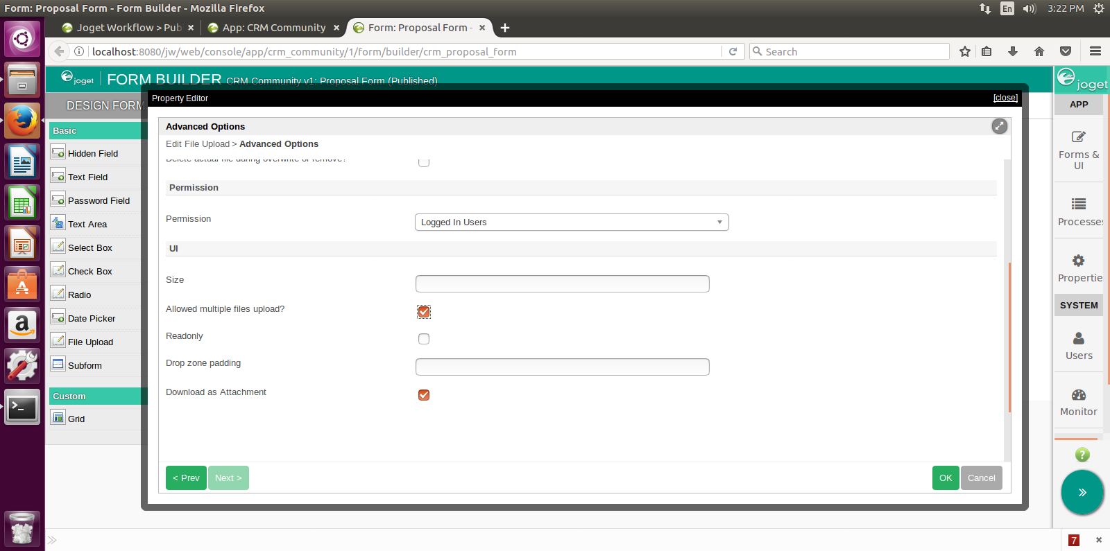

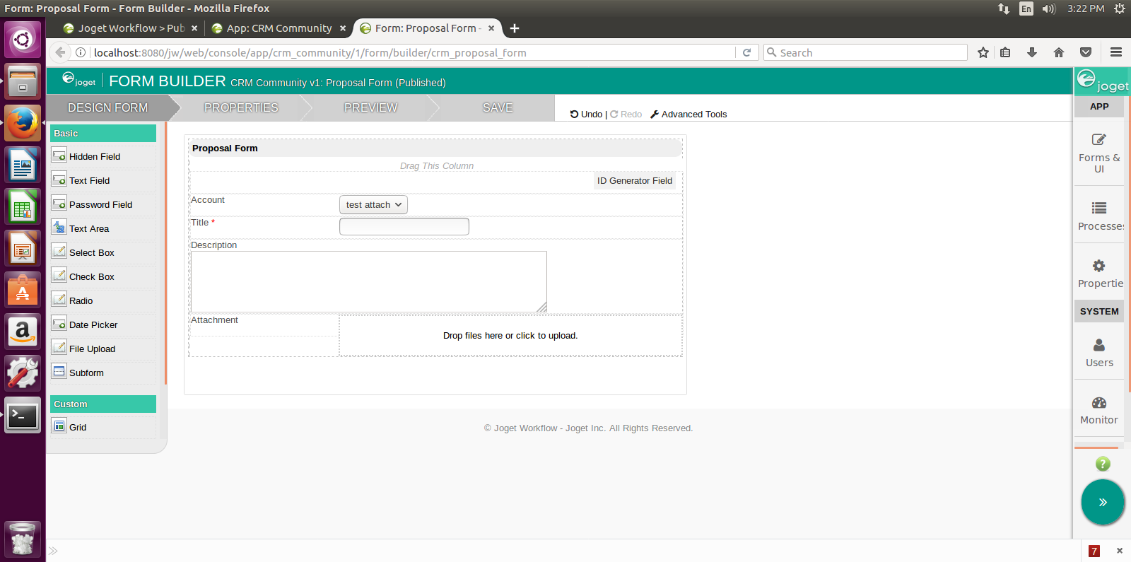

      Thank you for answered my question. Here are screenshots from the example app. I've tried to change the configuration of the form as you can see.

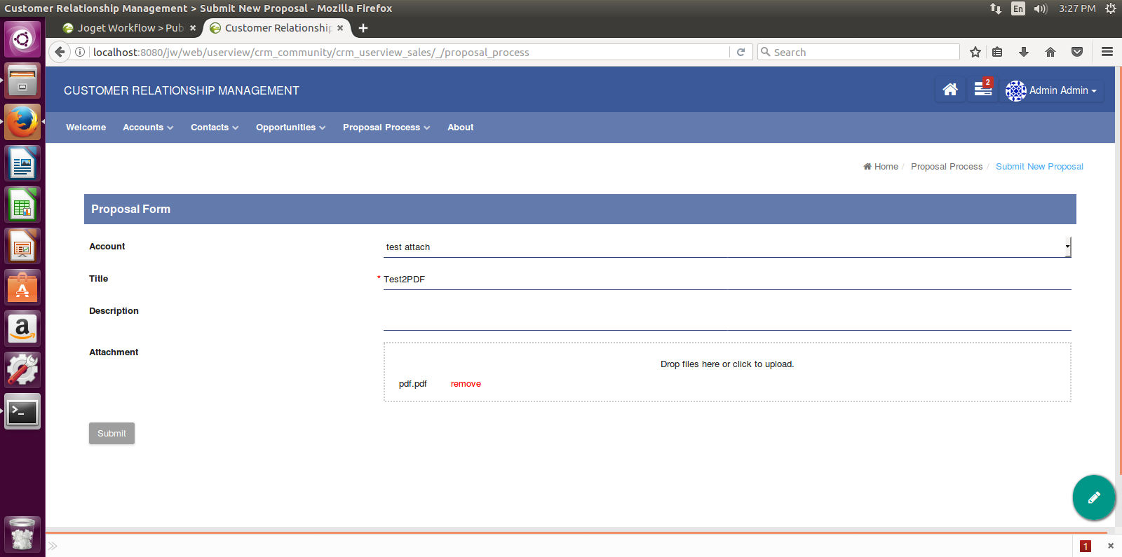

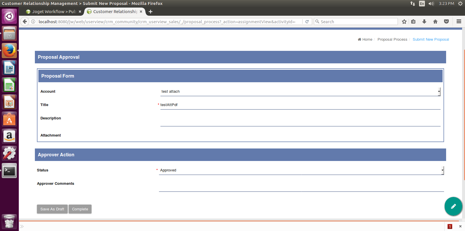

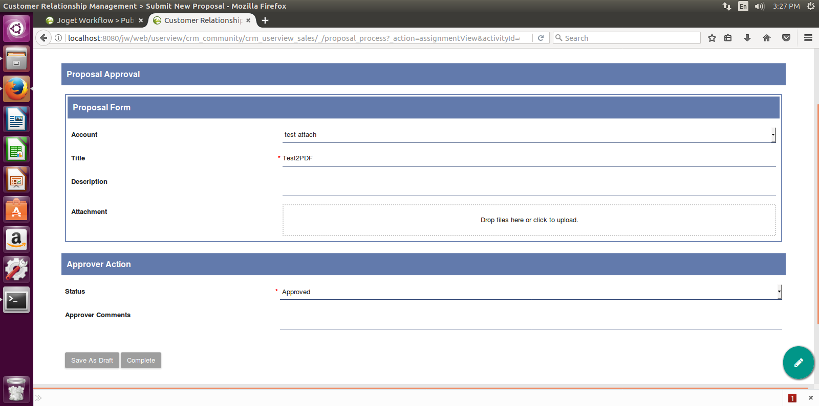

      1. Sumet Siriruangampai
        I've used "Customer Relationship Management" example app and I've attached file in the "submit new proposal" menu. After I submit the form, there is no file on the "approval form".
