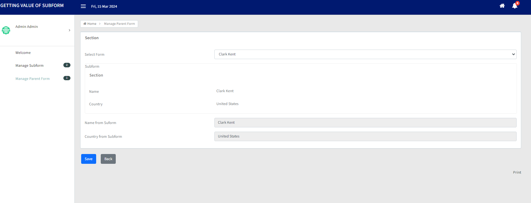

   I'm testing this recomendation Getting Value of Subform and note that it don't work as expected, please anybody can try to use the demo and tell me if have solution to fix it? .  I'm nedding use this script to improve my application.
Bellow is the evidence of the problem, I have did two tests in different testing enviroments and get the same issue.
thanks

        My Friend Bastiana , I found the problem in the original code that come with the demo application .
        The code lack of this part in bold
            $(document).ready(function(){
                selectmain = $(FormUtil.getField("field1")); //Get ID of subform
                selectmain.on("change",function(){
                    setTimeout(function(){
                        my_name = $("#field2_subform_name"); //Get subform value
                        my_country = $("#field2_subform_country");
                        my_date = $("#field2_subform_date");
                        var field1 = FormUtil.getField("field3"); //Get field of form
                        var field2 = FormUtil.getField("field4");
                        $(field1).val(my_name.val()); //Set field to value of subform
                        $(field2).val(my_country.val());
                    },1200);
        </script>
        Now is working fine.
