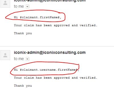

ur hash variable is not a valid syntax. u can refer to the list Hash Variable.

owh!...thank you panda. i just found it. it should be #performer.new_claim.firstName# thanks a lot for the recommendations note.
i have a problem with email notification in hr expense claim app. i installed email tool plugin. i cannot edit the claimant's name in the email. second problem is the font of the message is very small too. how i can edit the font?
