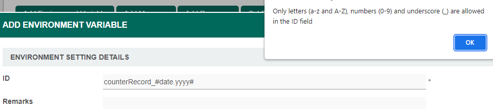

I tried implement your method, however I cannot create the environment Variable Name with '#'. I am using version DX7 Enterprise Trial.
