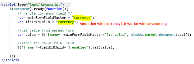

Hi Andrew,
I manage to solve the problem. Custom HTML should be placed on top of 'document no dropdown' field.
I manage to do it for currency2 as hidden field as well.
Thank you very much for the suggestion.

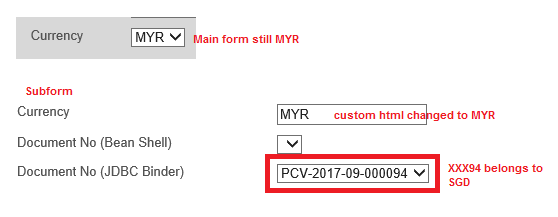

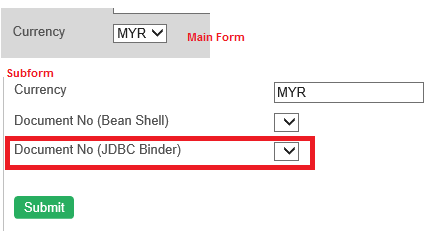

Hi Andrew,
Thank you for the suggestion. But, the value doesn't change based on my text box.
Let me explain further.
1) I have 3 documents, 2 documents for MYR(XXX092,XXX093) and 1(XXX094) Document for SGD.
2) The currency selector is in main form
3) I have a form grid and the document id selector is over here. Therefore, I have created a Custom HTML to hold the currency field value from parent form. And, the currency field in child form should be a hidden field. (For now, I'm doing it as textbox to see if the dropdown works). let's call it currency2.
4) For my document id dropdown, i have checked the 'Use AJAX for cascade options?' option and added the field id to control to currency2.
5) a) currency2 'Value' property is null. Therefore, CustomHTML set the value based on the parent form value. However, the dropdown doesn't work.
b) currency2 'value' property set to SGD. I selected MYR in main form, Currency2 field changed to MYR. But, the dropdown showing SGD document ID.
