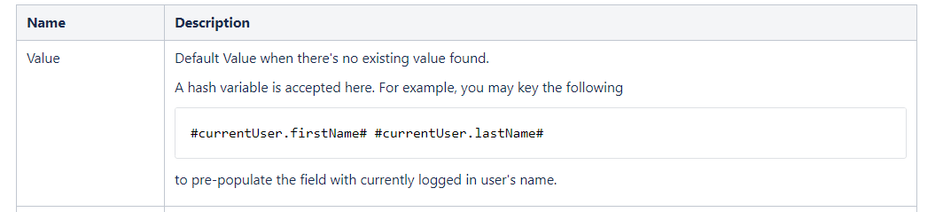

      You can refer this first : > Text Field
