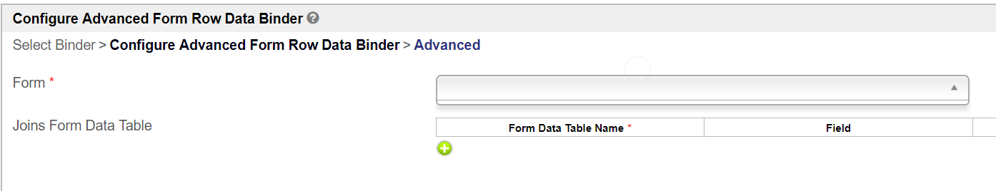

  1. The datalist source configuration can't retrieve fields when joining another table or even the form in some cases (clicking on the form gives an empty result:

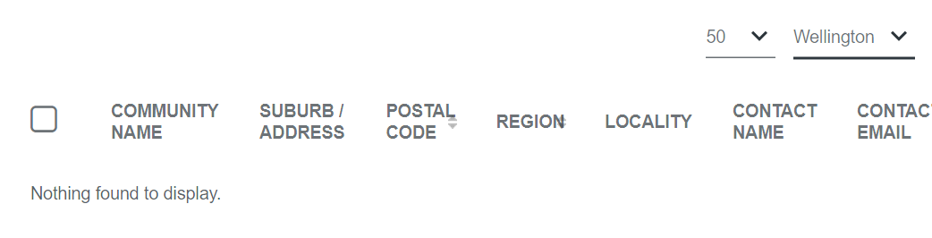

  2. The datalist filter (options binder) can retrieve the options from the datalist but when pressing "show", no record is shown:

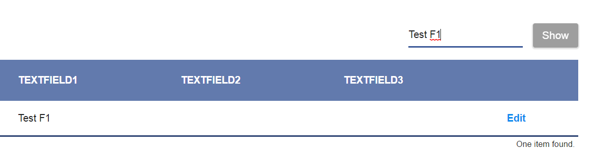

      1. We will fix the datalist source configuration issue in next v6 beta. Thank you for highlighting.
      2. For datalist filter to work, I removed the "Default Form Options Binder" selection. It works after this.
        Hi @Andrew,
        I tested your app and yes, the same problem still exists (only in the BETA3 instances I am running though.)
        The BETA3 instances are running on MySQL 5.6 - one on Windows 10, one on Ubuntu. BETA2 on Ubuntu and MySQL 5.7 works fine.
        I attached the screenshot below for your reference.

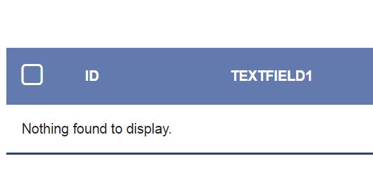

        For the second error, I added something to your sample app to demonstrate and the following happens when I try to filter f1:
        It's weird because in this example, Test F1 comes up as an option but then the result is empty

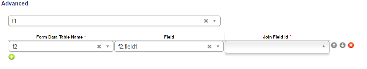

          Hi Eric
          I wrote a simple app with 2 forms and 2 tables, and joined them using the datalist advance datasource option. It works well in both MySQL and MSSQL. Attached is the app. APP_29032483.jwa
          Based on this app, can you simulate the issue?
          Or you can give me a sample app with a subset of your whole app (for privacy reasons) containing just the forms and list and userview giving the errors. Do specify which database you are using too.
