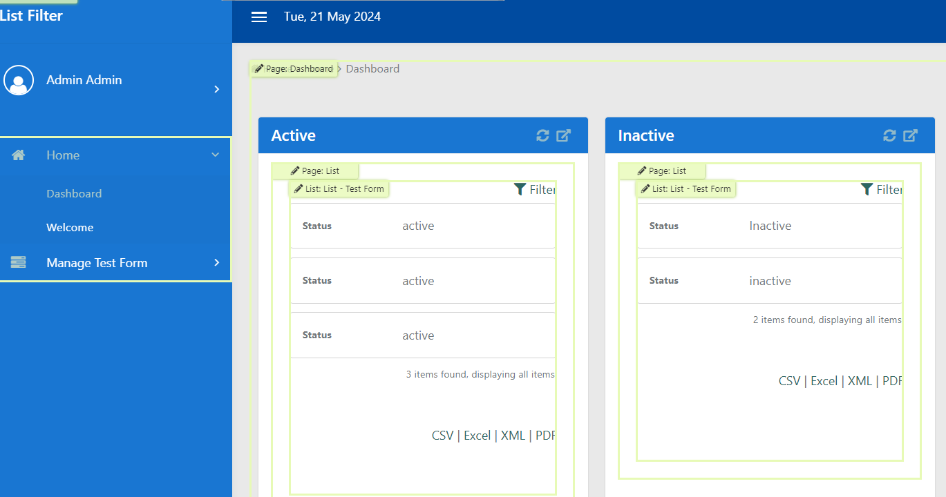

      I suppose that default option cannot be removed.
      However , you can try using a dashboard portlet.
      where, you can show a portlet with specific status only.
      say,
      portlet 1 : Active
      Portlet 2 : Inactive.
      I tried on my own too on this. APP_list_filter-1-20240521090243.jwa
      feel free to download the app and and use the method in your app.
      let me know if this helps!
