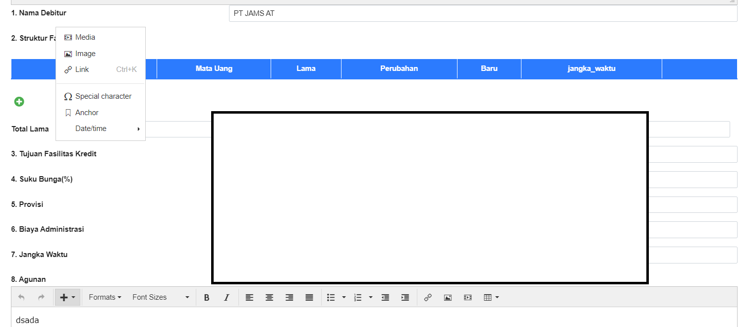

how i can fix this rich text editor because the popup didn;t show on in same field?

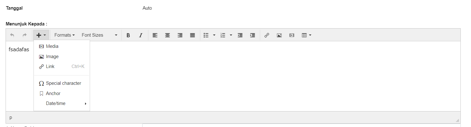

i have example the picture for in the top is fine when i test
but the issue when i try in the second or more rich text editor
as you can see the pop up in the top so how i can fix this ?
      Hi, what version of Joget are you using. ?
      i tested on the cloud version (8.1.1) it works fine.
      there is an upgrade of the TinyMCE Rich Text Editor in the latest Joget DX8.1 onwards.
      Version 8.1.0#:~:text=%5B%20MODIFIED%20%5D%20%C2%A0%20%C2%A0%20CORE%20%C2%A0%20%C2%A0%20%C2%A0%20%3A%20Security%20%2D%20Upgrade%20TinyMCE%20to%207.0.1.
