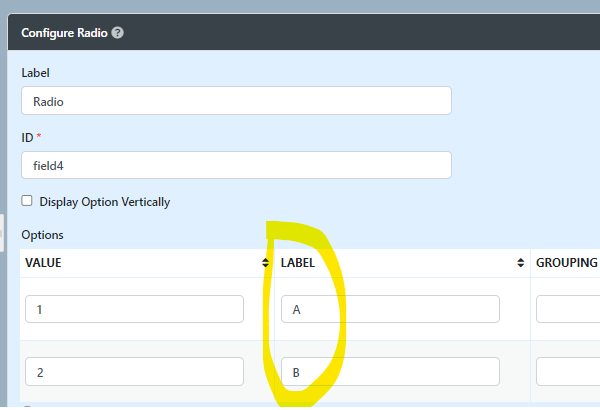

Hi there experts! i want to access the label of the option selected in the radio instead of the value. For example, a have a radio with two options, A (value is 1) and B (value is 2). Is there any way to access the respective label of the option selected? In this case if i select A, i want to access by a binder the LABEL A, but when i use binder i can only get the value 1.

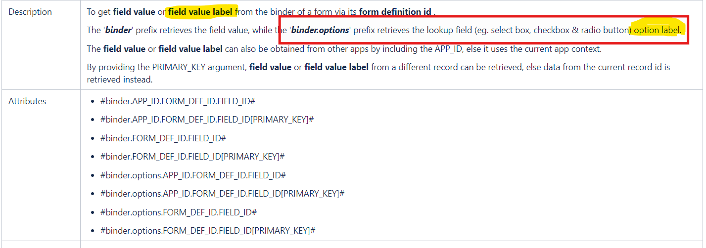

      have you tried the binder.options ?
      say .
      FORM_DEF_ID : formA
      FIELD_ID : radio
      Change from
      #binder.formA.radio#
      (will show value : 1,2)
      to
      #binder.options.formA.radio#
      (will show label A,B)

        Thats it, thank you very much for your time.
