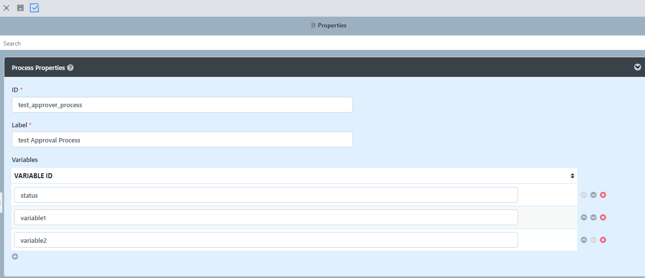

I have a form with many fields.
I have defined a workflow variable for each field.

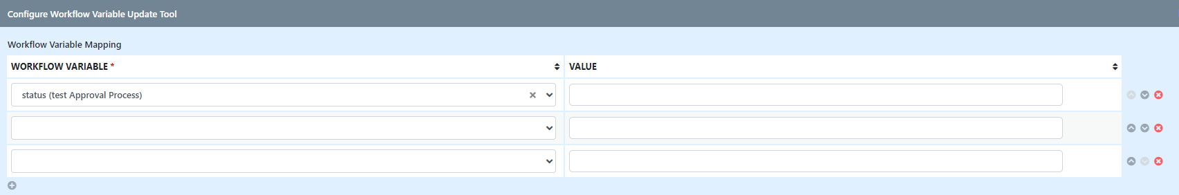

But I can only select one workflow variable and not the rest in:
--- Workflow variable update tool
--- 'variable' field in the 'configure simple rules' section of process 'routs'
can't I have more than only one workflow variable?
      Use the + button to add / update more than 1 wflow variable in route and wflow variable update tool. Also make sure you have added all  the workflow variables in the process properties.
