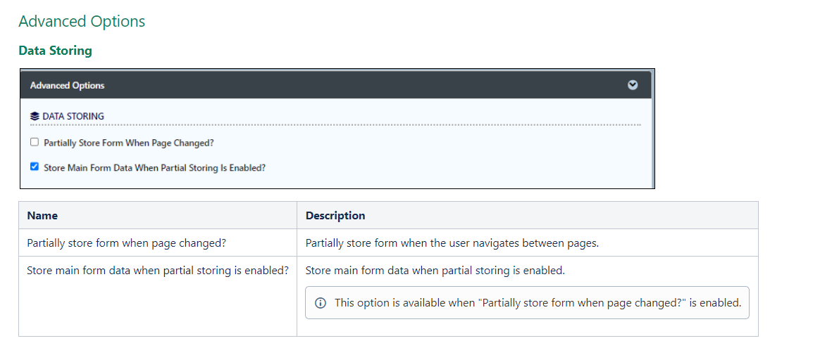

On the other hand, You might be able to leverage the multi page form element to segregate the long forms to different sections.
This Feature has the ability to auto save content even without clicking the submit button.
Multi Paged Form#,Data%20Storing,-NameAdd your comment... - 10-1
