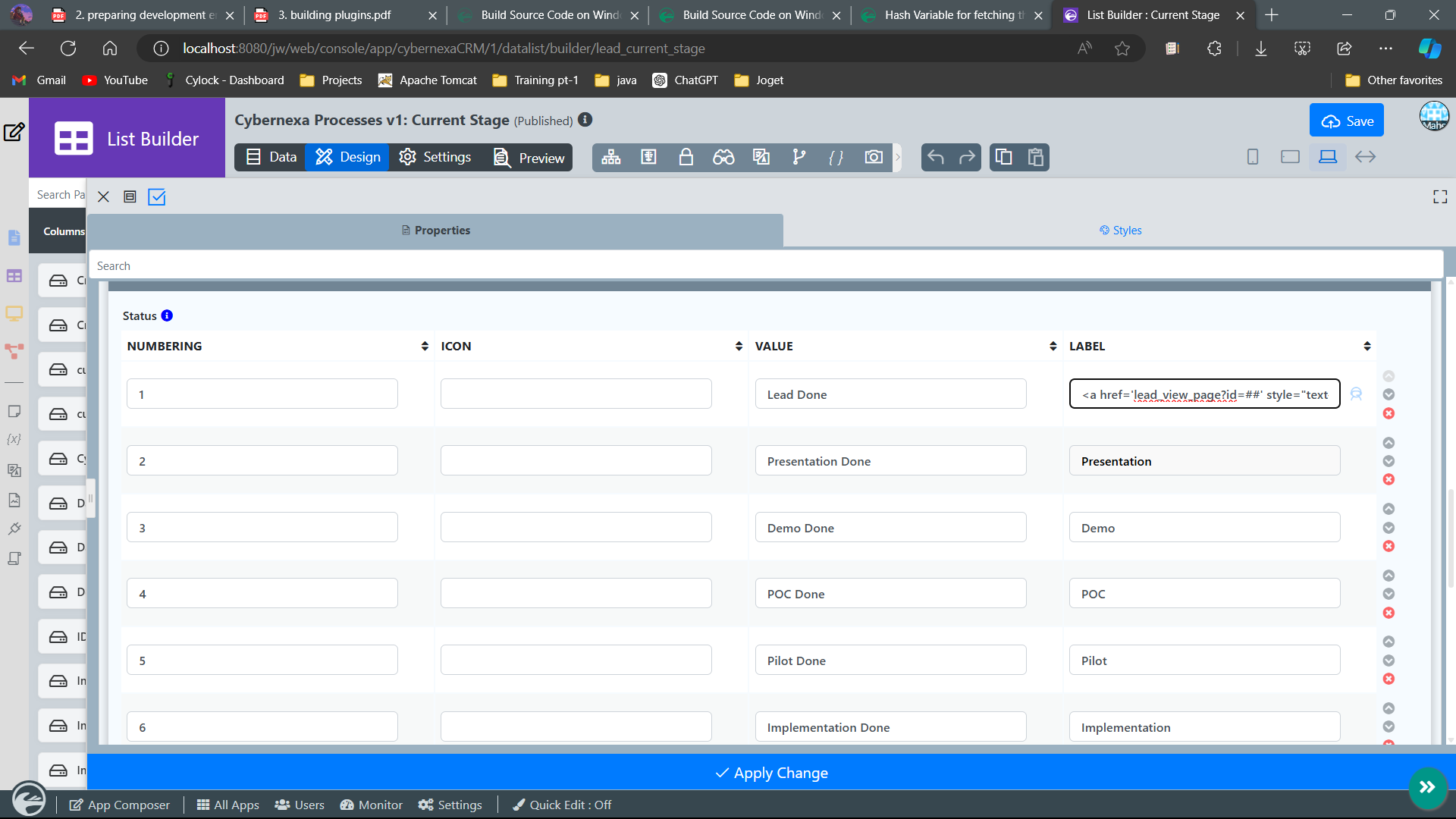

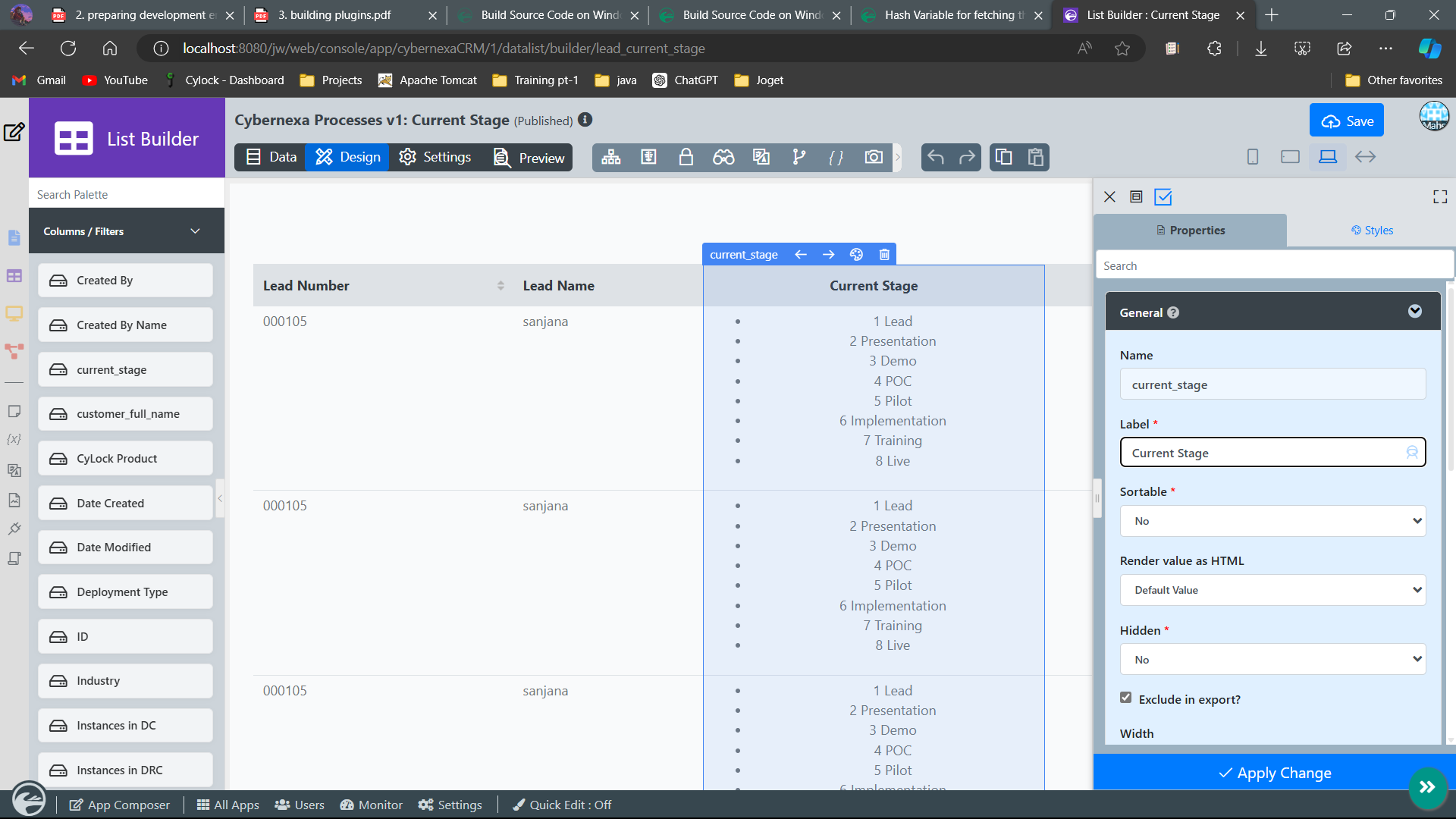

well its kinda complex. I want to use it in bootstrap steps formatter plugin as you can see i need to use it in <a> tag

I have the same problem. I have a list hyperlink action (row based) and I need to append in its hyperlink value the content of a column in the row that the hyperlink action belongs to, for example
"predefined URL" + "a current row column cell content"
, I found that there is a "datalist.col......# hash variable collection but there is not something that gives the content of a column cell. Those hash variables refer to either to the content of a column or in aggregate functions for all cells in a column.
