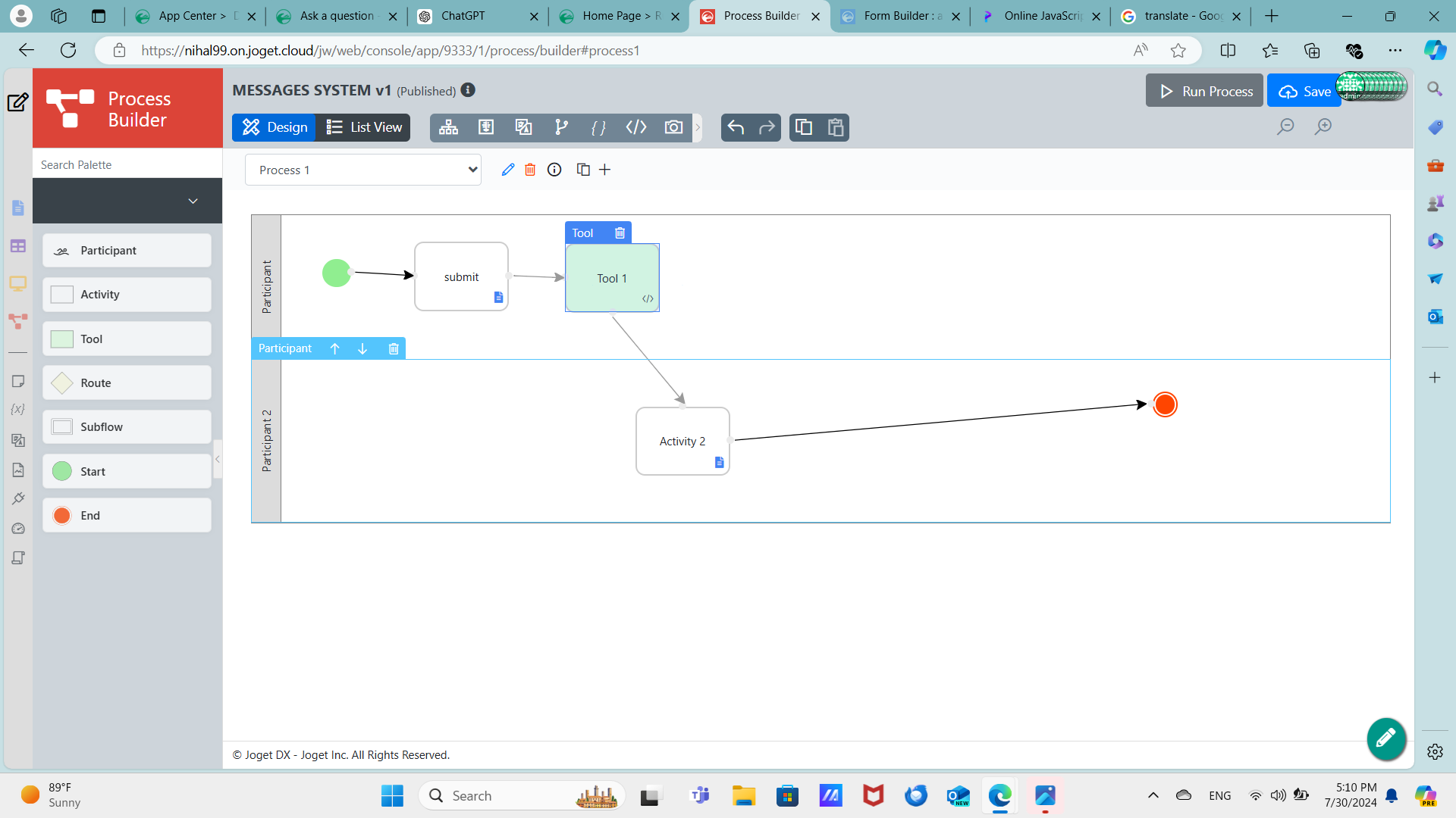

Why is the code in the tool not working? So it does not modify the value of the variable
please delete it first activity (submit), and you direct the arrow to tool 1.
in the tool 1 can you select the required plugins, for example email notifications plugin.
try running the flow again
