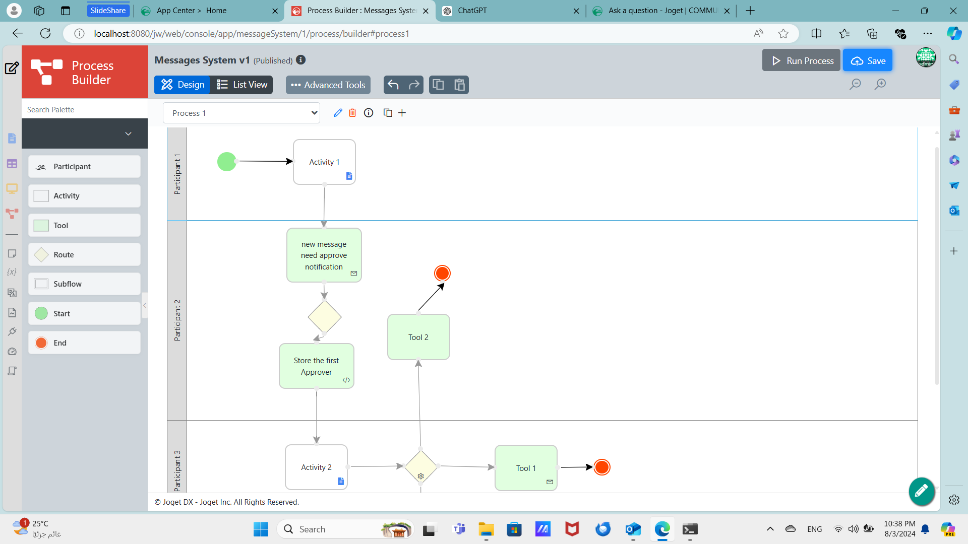

i build a process, and ihave intilize a workflow variables as this (var1: contain values which user selected from multi selected box , var2: its a hidden field for storing the first value from var1(have default value 'empty')
so i write a java code and put it inside a tool but it does not work , not storing the first value from the var1 to var 2
this is the code
