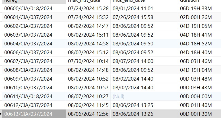

and is working on mysql

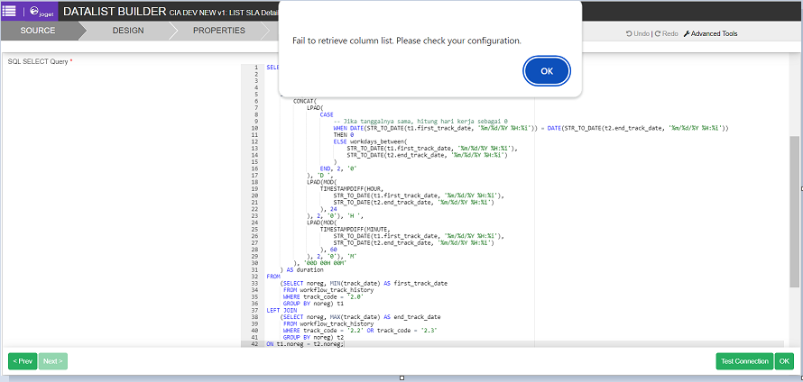

but when i try put on datalist
so is possible to add datalist from subquery on datalist ?
if possible how to do it ?

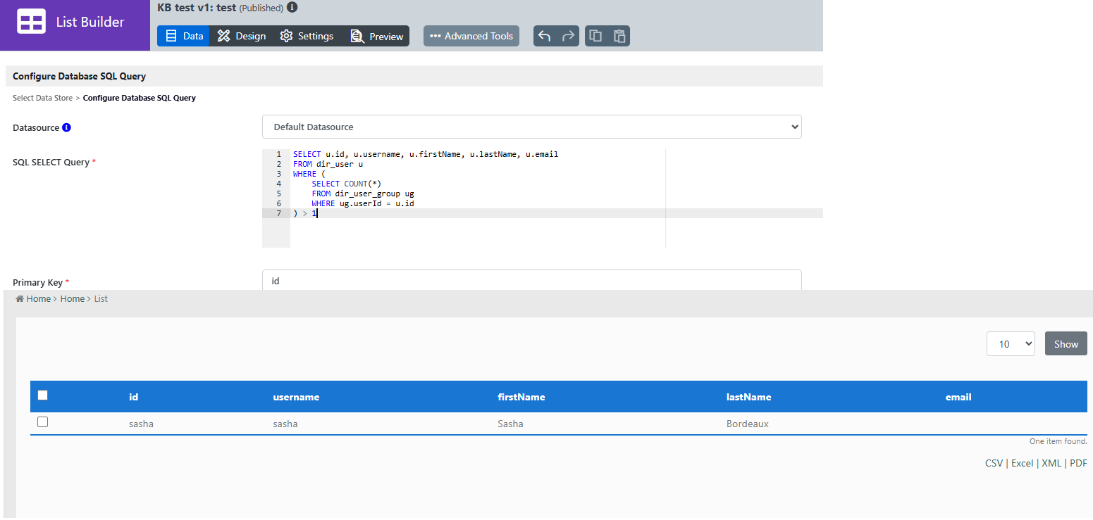

      just did a quick test. seems to work for me. latest Joget version on mysql.
      oh, ensure you don't have a semicolon ( ; ) at the end of the query
