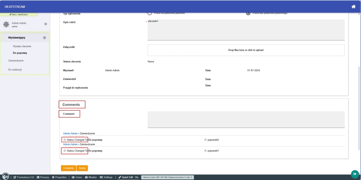

look into the .jar file located at wflow/app_plugins/process_enhancement-7.x.x.jar . it's basically Java Archive file, so use WinRAR, 7-Zip, or WinZip to open it up and look for properties file. should be in message > form > AssignmentFormActions.properties to get the message key.
Hello,
I am working on app using Process Enhancement Plugin and I have a problem with translation of built-in comment section. Is there any posssibility to translate labels I marked on the screenshot below?
I know about Add Message in Properties and export - my app is partly translated using this, but in this case I have no idea how to create suitable key in Add Message. I would be delighted by a working example (maybe .po file?).
Thank you in advance for any help.
