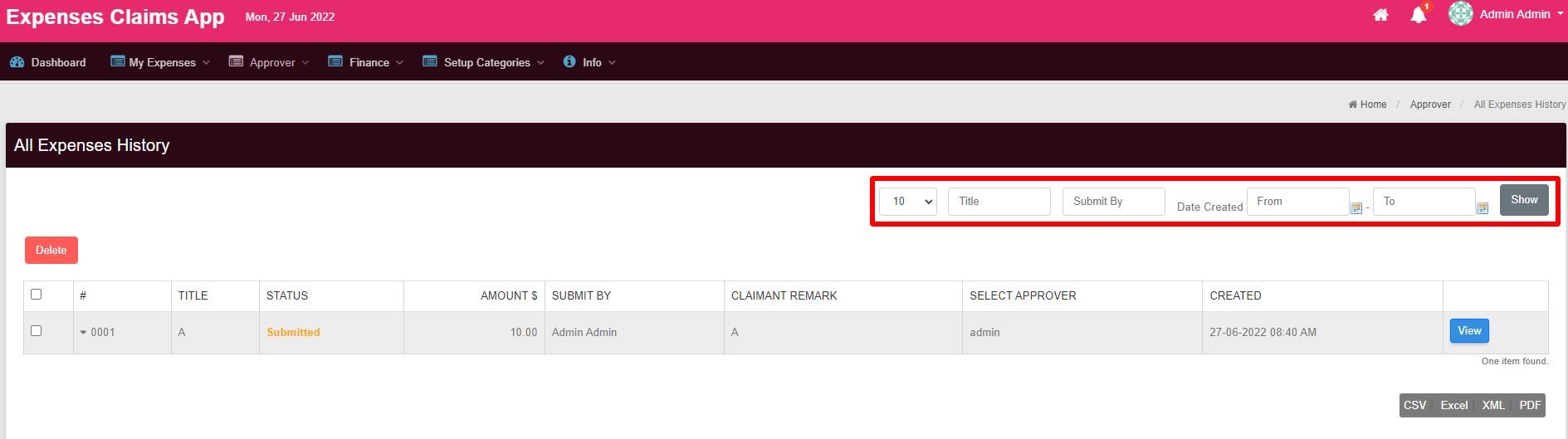

How can we edit the List filter search button caption? There is nowhere to edit its properties! I want to change it from Show to Search or Filter.
      There's a low code way of doing it using Javascript. You can just add
      <script>
      document.querySelector('.form-button').value = 'Search';
      </script>
      to Configure CRUD > UI (List) > Custom Header
      1. Nik
        I use script page component to put this code (without <script> tag) and worked. But there are more than one html tags that have this class. For this particular situation there in no problem but I think that it is a dangerous approach since the button doesn't have an id.
      2. Nik
        Also because this is a front-end approach and not back-end (late approach since the change is done after DOM loaded) the old value is still there if you view the HTML source code and also in the joget form!!!
