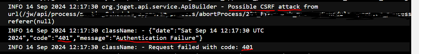

I need to make an API call that is created from Joget's API Builder of a Process element, specifically to abort a process instance. However, while trying to make the API call via BeanShell tools in a Process in the Process Builder, I encountered an issue related to authentication error and was stuck trying to resolve this issue. I print out the error message in the server log, as displayed below.
The snippet of the logic I used to make the API call is as below:

      possible CSRF attack could mean you may have not enabled API whitelisting. Add "*" in the general settings under API Domain whitelist. Additionally you can check whether you have generated a API key and using the right one.
        After lots of trial and error and at the same time researching about the appropriate ways on how to execute aborting a process via BeanShell tools, I ran into this similar question, as below, and finally was able to proceed aborting a process with just 2 simple lines of codes used in Process Monitoring Utility app, instead of using the the API implementation. Wish I found about this sooner though..
