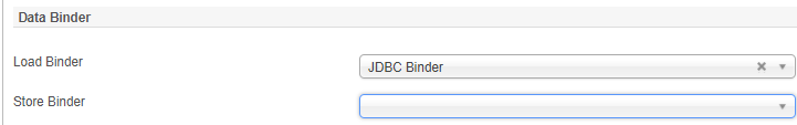

Hi Panda, my closed subtasks list grid actually is using the jdbc binder to load data (image as below). My intention just want to display the record with no insert and update. Just wondering why the records will be removed once the Save button is clicked?
I think currently the multirow form load and store binder will remove the record not in the grid before it stores to database. You will need a custom store binder like JDBC Store Binder if you want a different behavior.
