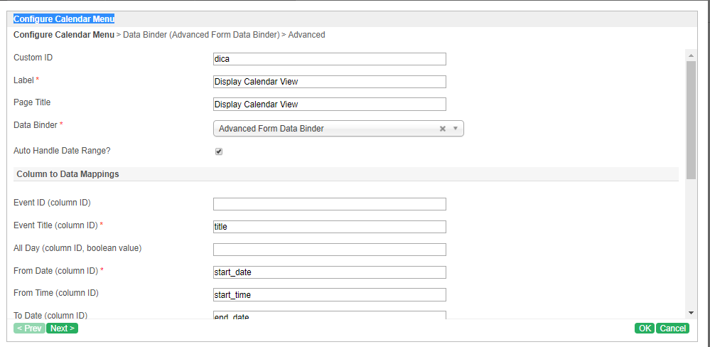

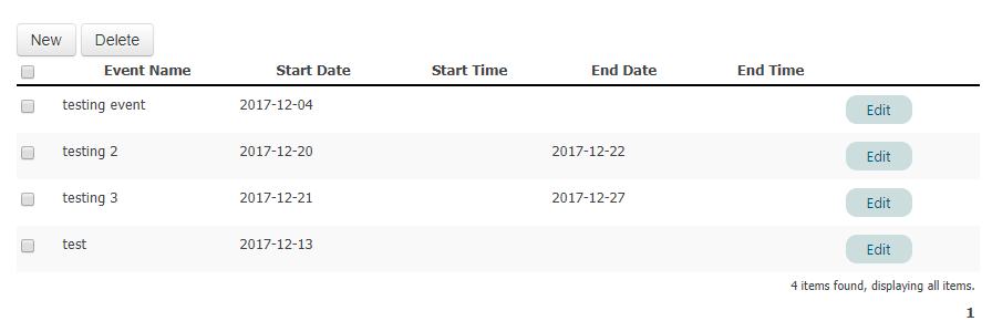

From your screenshot, "start time", "end date", "end time" are not always filled up with values. That can be a cause too.

I wont know unless I can see your app or a print screen of the calendar properties :-) Do ensure your SQL is correct and working.

Hi Andrew, the print screen is attached. I am using the advanced form data binder to retrieve the calendar info. Not using SQL.

First of all, the sample Calendar App is working fine. Anyhow if I copied over the sample design onto my App, it is not working for the calendar view (empty view). The input form & datalist are working fine. Below screenshots attached for your further reference. Would appreciate for your advice. Many thanks ahead.
Datalist

Calendar Properties
