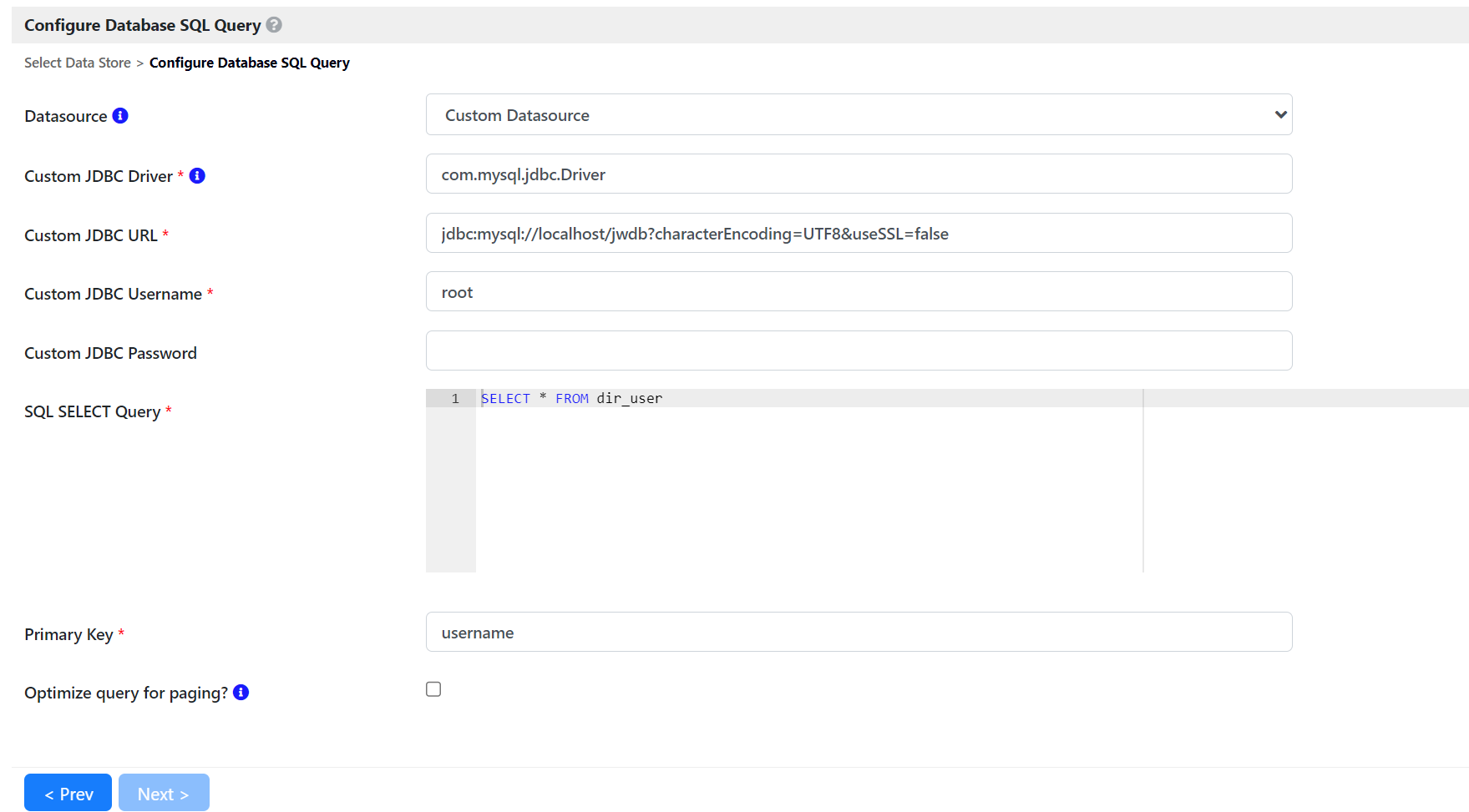

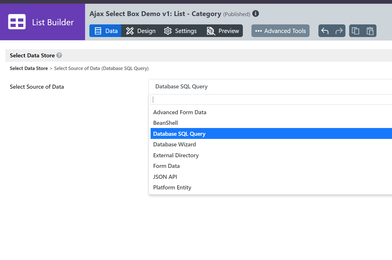

Go to datalist builder → Data → You can choose Database SQL Query / Database wizard (Both these options support custom datasource option other than your default database) → You need to enter the connection string and Driver details.
If you encounter any issues connecting via the custom datasource option, consider developing a custom plugin for DB2 integration. This approach, while more involved, would allow you to create a tailored solution for seamlessly connecting Joget to your DB2 database.
