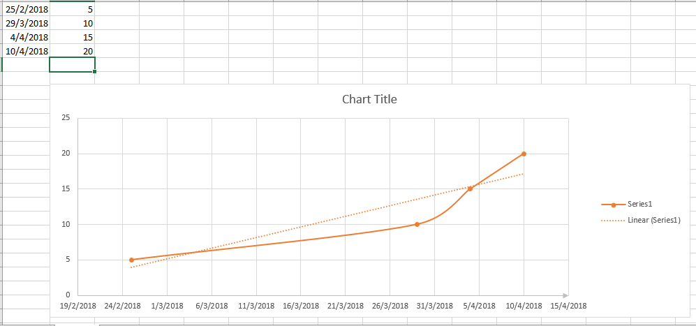

I would like to plot graph in form builder instead of userview.
The graph is plot based of the X and Y value in the page itself.
Example : for X is all the dates, Y is all the sales amount.
Can this be done?
