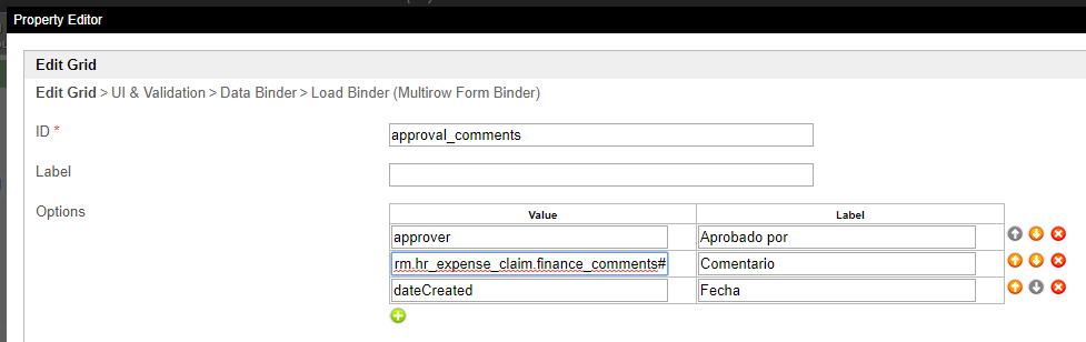

Hi Experts,

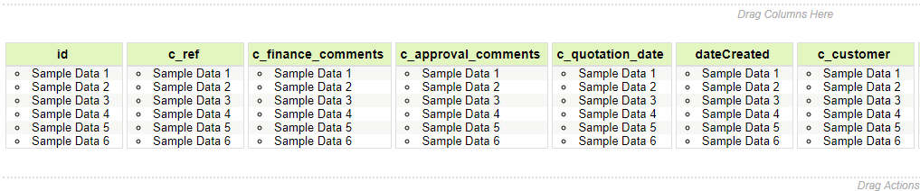

I have a form and have a Grid on it, i need load fields from same table that is used by the form , i did try using form hash variable but this option  don´t get info.
Note: If i use a text box i can get the value of field without problems¡
This is the Table structure of the table:
In other hand i know that i can use bean shell to load data but need help to understand better the code,  i´m using the example bellow:
Facts:
The table have an id field named id  as we can show in the example
