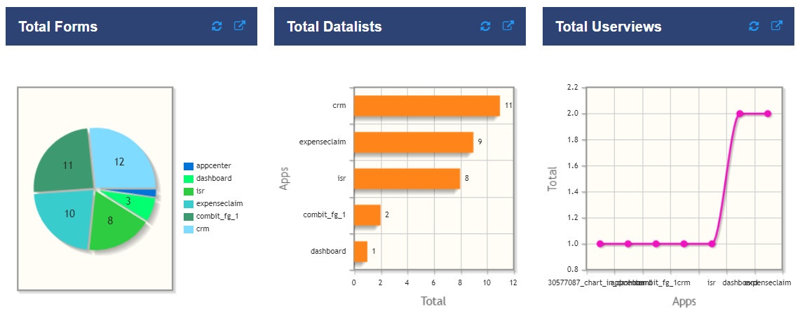

Attached is a demonstration app to using charts in dashboard for Joget Workflow v6.
Do import this app, publish it and run to view 3 charts in a single dashboard page with no scroll bars.
You can view the settings used in the userview builder to learn how it was done.
Hope this helps.
Download app: APP_30577087_chart_in_dashboard.jwa

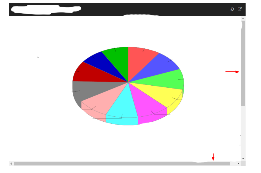

try additional command "embed" in link address (URL).
- Otik Indriyana
can you share step by step that command? example: open menu A -> edit on URL
Hi
In "Userview Builder > Dashboard > URL Portlet Setting: URL" add (in bold):
<menuId>?embed=true
to remove the header and footer in your portlet, this will reduce the height and width of your chart.
In addition, in your chart properties, set the width and height to 70% or 80%.

how to remove vertical and horizontal scroll on dashboard?
thx before
