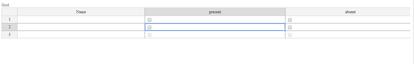

i used the Multirow Form Binder but it just stores the data in the right table i want the spreedsheet to be outputted with the names from the other form
HI
i want to do a spreadsheet in a form for students absent record like this
My question is how i can load the students name from another table ?
