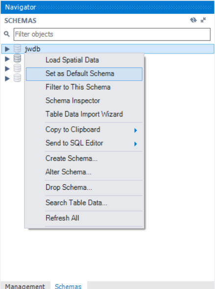

first create database using this command
CREATE SCHEMA jwdb
after that open the sql file in any database tool (i suppose you are using mysql workbench) and run that sql script. for workbench you use this button.
but make sure before running this script that the default database is jwdb. you can make it using the following
- Sarah
Thank you so much! it worked.
