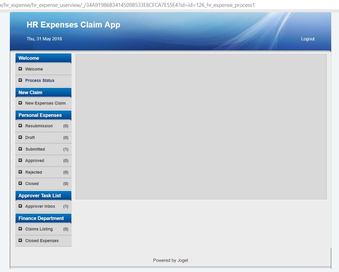

Hi, the URL in the screenshot shows the parameter duplicated id=id=xxxx.. it should just be id=xxxx

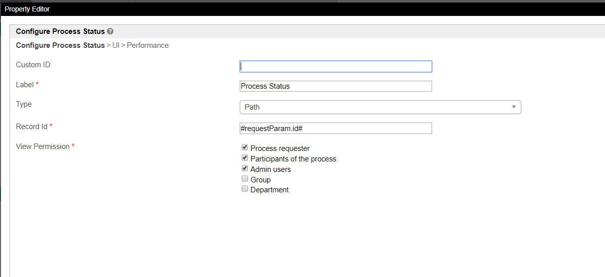

Hi, I am working on my app. I have other apps with similar setup and all worked without issue. This one I know I have passed the ID properly, but it shows 0% and nothing about the flow. what could I be missing here?

I downloaded the HR Expenses Claim app and configured the process status like in the KB article and I get a blank. is this a bug?
