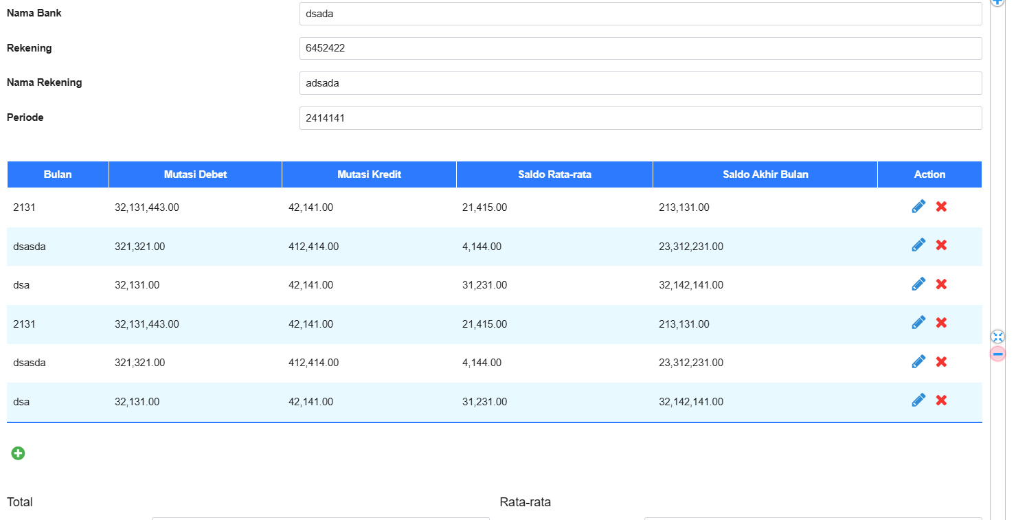

bug video subform repeater form grid when more than 3.mp4
i already show the video . so always happen this issue on subform repeater 7.0.7 multiple button on form grid.
and if i try save again is always bug , the value become duplicate like this picture
part 2
so from 3 row subform become 2 row subform
i already try use 7.0.8 - 7.0.9 but somehow in form grid all button on form grid is gone. so how i can fix this.
