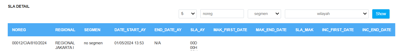

is possible to modify datalist with merge header? and is possible to modify export pdf datalist ?
 for example
this is my joget datalist right now
and i want make like this on datalist
so i can add title on top start,end,and sla
this is for export or download pdf  datalist.
is possible i can edit the pdf so i can make bigger size
      Out of the box, I don't remember Joget list builder able to create table header with 2 levels. You can try external library such as jasper report and use JasperReports Menu to integrate into Joget.
