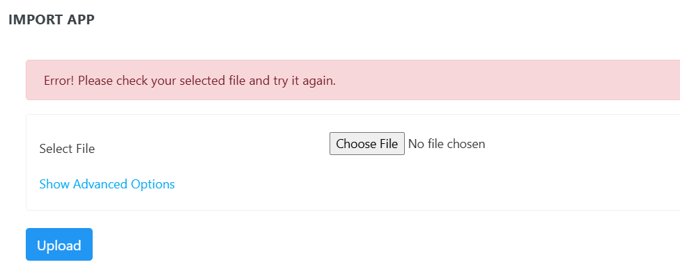

when every I try to import an app from the local host i get this error.

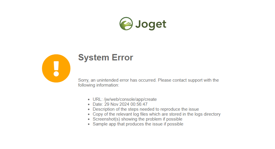

I have also noticed when I also create a new app i get this error also.
I have added the two error message in the system log
One is when i import the file
the second is when I add new app
I suspect the error is in
ERROR 29 Nov 2024 00:55:35 org.joget.apps.util.AppLicenseUtil - java.lang.IllegalArgumentException: Invalid value: gpg.format=ssh
but have no idea how to fix it

Caused by: java.lang.IllegalArgumentException: Invalid value: gpg.format=ssh
1124
    at org.eclipse.jgit.lib.DefaultTypedConfigGetter.getEnum(DefaultTypedConfigGetter.java:103) ~[org.eclipse.jgit-6.8.0.202311291450-r.jar:6.8.0.202311291450-r]
1125
    at org.eclipse.jgit.lib.Config.getEnum(Config.java:454) ~[org.eclipse.jgit-6.8.0.202311291450-r.jar:6.8.0.202311291450-r]
1126
    at org.eclipse.jgit.lib.GpgConfig.<init>(GpgConfig.java:86) ~[org.eclipse.jgit-6.8.0.202311291450-r.jar:6.8.0.202311291450-r]
1127
    at org.eclipse.jgit.api.CommitCommand.processOptions(CommitCommand.java:662) ~[org.eclipse.jgit-6.8.0.202311291450-r.jar:6.8.0.202311291450-r]
1128
    at org.eclipse.jgit.api.CommitCommand.call(CommitCommand.java:189) ~[org.eclipse.jgit-6.8.0.202311291450-r.jar:6.8.0.202311291450-r]
1129
    at org.joget.apps.app.service.AppDevUtil.gitCommit(AppDevUtil.java:448) ~[classes/:?]
1130
    at org.joget.apps.app.service.AppDevUtil.fileSave(AppDevUtil.java:987) ~[classes/:?]
1131
    at org.joget.apps.app.dao.AppDefinitionDaoImpl.saveOrUpdate(AppDefinitionDaoImpl.java:176) ~[classes/:?]
1132
    at org.joget.apps.app.dao.AppDefinitionDaoImpl.saveOrUpdate(AppDefinitionDaoImpl.java:46) ~[classes/:?]
1133
    at java.base/jdk.internal.reflect.NativeMethodAccessorImpl.invoke0(Native Method) ~[?:?]
1134
    at java.base/jdk.internal.reflect.NativeMethodAccessorImpl.invoke(Unknown Source) ~[?:?]
1135
    at java.base/jdk.internal.reflect.DelegatingMethodAccessorImpl.invoke(Unknown Source) ~[?:?]
1136
    at java.base/java.lang.reflect.Method.invoke(Unknown Source) ~[?:?]
1137
    at org.springframework.aop.support.AopUtils.invokeJoinpointUsingReflection(AopUtils.java:344) ~[spring-aop-5.3.39.jar:5.3.39]
1138
    at org.springframework.aop.framework.ReflectiveMethodInvocation.invokeJoinpoint(ReflectiveMethodInvocation.java:198) ~[spring-aop-5.3.39.jar:5.3.39]
1139
    at org.springframework.aop.framework.ReflectiveMethodInvocation.proceed(ReflectiveMethodInvocation.java:163) ~[spring-aop-5.3.39.jar:5.3.39]
1140
    at org.joget.apps.app.service.AuditTrailInterceptor.invoke(AuditTrailInterceptor.java:17) ~[classes/:?]
1141
    at org.springframework.aop.framework.ReflectiveMethodInvocation.proceed(ReflectiveMethodInvocation.java:186) ~[spring-aop-5.3.39.jar:5.3.39]
1142
    at org.springframework.transaction.interceptor.TransactionInterceptor$1.proceedWithInvocation(TransactionInterceptor.java:123) ~[spring-tx-5.3.39.jar:5.3.39]
1143
    at org.springframework.transaction.interceptor.TransactionAspectSupport.invokeWithinTransaction(TransactionAspectSupport.java:388) ~[spring-tx-5.3.39.jar:5.3.39]
1144
    at org.springframework.transaction.interceptor.TransactionInterceptor.invoke(TransactionInterceptor.java:119) ~[spring-tx-5.3.39.jar:5.3.39]
1145
1146
    at org.springframework.aop.interceptor.ExposeInvocationInterceptor.invoke(ExposeInvocationInterceptor.java:97) ~[spring-aop-5.3.39.jar:5.3.39]
1147
1148
    at org.springframework.aop.framework.JdkDynamicAopProxy.invoke(JdkDynamicAopProxy.java:241) ~[spring-aop-5.3.39.jar:5.3.39]
1149
    at com.sun.proxy.$Proxy127.saveOrUpdate(Unknown Source) ~[?:?]
1150
    at org.joget.apps.util.AppLicenseUtil$1.doInTransaction(AppLicenseUtil.java:74) ~[classes/:?]
1151
    at org.springframework.transaction.support.TransactionTemplate.execute(TransactionTemplate.java:140) ~[spring-tx-5.3.39.jar:5.3.39]
1152
    at org.joget.apps.util.AppLicenseUtil.getAppLicense(AppLicenseUtil.java:68) ~[classes/:?]
1153
    at org.joget.apps.util.AppLicenseUtil.getUnprotectedAppList(AppLicenseUtil.java:486) ~[classes/:?]
1154
    at com.sun.proxy.$Proxy142.getUnprotectedAppList_aroundBody5$advice(Unknown Source) ~[?:?]
1155
    at com.sun.proxy.$Proxy142.getUnprotectedAppList(Unknown Source) ~[?:?]
1156
    at org.joget.apps.app.controller.ConsoleWebController.consoleAppCreate(ConsoleWebController.java:1456) ~[classes/:?]
1157
    at org.joget.apps.app.controller.ConsoleWebController$$FastClassBySpringCGLIB$$e1402d89.invoke(<generated>) ~[classes/:?]
1158
    at org.springframework.cglib.proxy.MethodProxy.invoke(MethodProxy.java:218) ~[spring-core-5.3.39.jar:5.3.39]
1159
    at org.springframework.aop.framework.CglibAopProxy.invokeMethod(CglibAopProxy.java:386) ~[spring-aop-5.3.39.jar:5.3.39]
1160
    at org.springframework.aop.framework.CglibAopProxy.access$000(CglibAopProxy.java:85) ~[spring-aop-5.3.39.jar:5.3.39]
1161
    at org.springframework.aop.framework.CglibAopProxy$DynamicAdvisedInterceptor.intercept(CglibAopProxy.java:703) ~[spring-aop-5.3.39.jar:5.3.39]
1162
    at org.joget.apps.app.controller.ConsoleWebController$$EnhancerBySpringCGLIB$$d32cbaec.consoleAppCreate(<generated>) ~[classes/:?]
1163
1164
1165
1166
1167
    at org.springframework.web.method.support.InvocableHandlerMethod.doInvoke(InvocableHandlerMethod.java:205) ~[spring-web-5.3.39.jar:5.3.39]
1168
    at org.springframework.web.method.support.InvocableHandlerMethod.invokeForRequest(InvocableHandlerMethod.java:150) ~[spring-web-5.3.39.jar:5.3.39]
1169
    at org.springframework.web.servlet.mvc.method.annotation.ServletInvocableHandlerMethod.invokeAndHandle(ServletInvocableHandlerMethod.java:117) ~[spring-webmvc-5.3.39.jar:5.3.39]
1170
    at org.springframework.web.servlet.mvc.method.annotation.RequestMappingHandlerAdapter.invokeHandlerMethod(RequestMappingHandlerAdapter.java:903) ~[spring-webmvc-5.3.39.jar:5.3.39]
1171
    at org.springframework.web.servlet.mvc.method.annotation.RequestMappingHandlerAdapter.handleInternal(RequestMappingHandlerAdapter.java:809) ~[spring-webmvc-5.3.39.jar:5.3.39]
1172
    at org.joget.commons.spring.web.ParameterizedAnnotationMethodHandlerAdapter.handleInternal(ParameterizedAnnotationMethodHandlerAdapter.java:32) ~[wflow-commons-8.1.8.jar:?]
1173
    at org.springframework.web.servlet.mvc.method.AbstractHandlerMethodAdapter.handle(AbstractHandlerMethodAdapter.java:87) ~[spring-webmvc-5.3.39.jar:5.3.39]
1174
    at org.springframework.web.servlet.DispatcherServlet.doDispatch(DispatcherServlet.java:1072) ~[spring-webmvc-5.3.39.jar:5.3.39]
1175
    at org.springframework.web.servlet.DispatcherServlet.doService(DispatcherServlet.java:965) ~[spring-webmvc-5.3.39.jar:5.3.39]
1176
    at org.springframework.web.servlet.FrameworkServlet.processRequest(FrameworkServlet.java:1006) ~[spring-webmvc-5.3.39.jar:5.3.39]
1177
    ... 95 more
      Hi, based on your error looks like you are facing issue with your git. Please refer https://stackoverflow.com/questions/74722894/error-unsupported-value-for-gpg-format-ssh
      1. M Tarek Hamwi
        I followed the link, and it says to update git to the lateset version. However, when I check my git version, it is already up to date.
