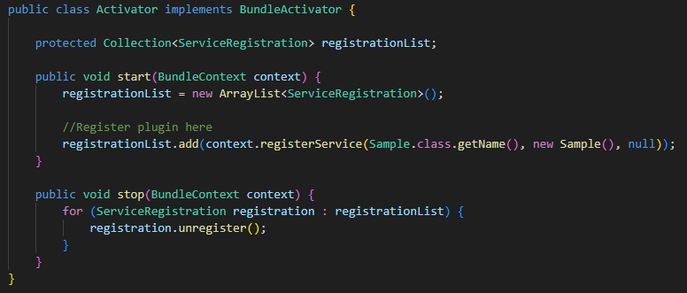

        Can you help to check on my Activator:

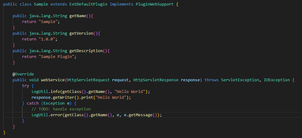

        My Sample Class:
        which part i need to change?
      4. Varnaa

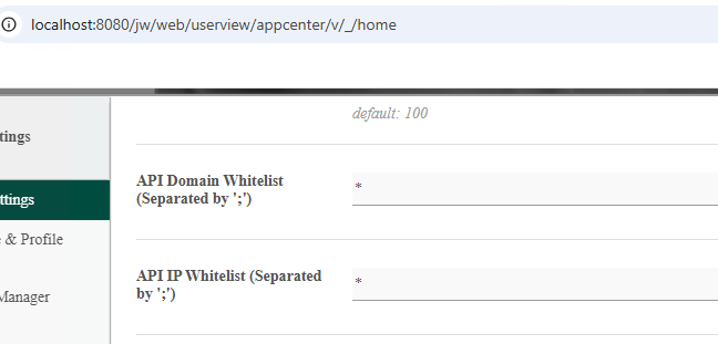

        404 error suggests Joget is not able to find the requested API. Can you check whether you have enabled whitelisting? Settings → General Settings and set the below fields as *
        As for your Activator and code it looks fine.
      5. vicky tan
        my whitelist is same as yours.
