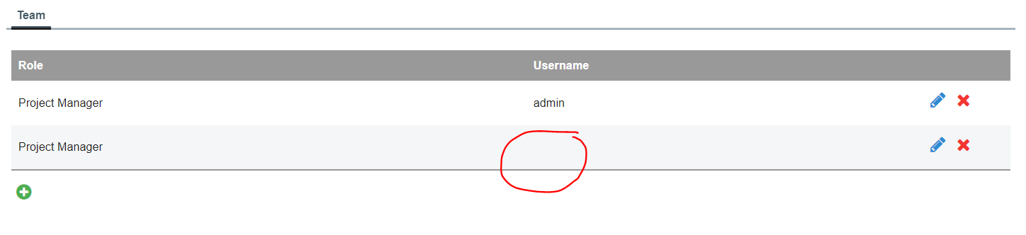

The form grid is on a Multi-Form Page with the following settings
When I create the record and click save on the parent form, no data appears in the username field (this field is from the SQL join). It only appears when I click to a different tab or when I reload the whole form. Is this normal and how can I fix this? thanks.

        hi, if not wrong, the load binder is a server side processing. the form grid add is client side. So, it won't appear until u submit u form.
