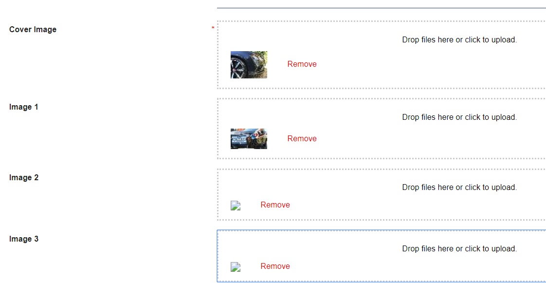

Please note that i am talking about the file chooser actually, which is somthing before form submission. When i click "Drop files here or click to upload" and choose an image, the thumbnail get broken and image fail to attached.
- Fawad Khaliq
Moreover the images i am using are 4KB in size.

I checked the logs catalina.log and joget.log (using command tail -f /opt/joget-xxxxxx) but no excepition is throwing. And no error in browser F12 developer console. The following is the form json, please create this form and test. { "className": "org.joget.apps.form.model.Form", "properties": { "noPermissionMessage": "", "loadBinder": { "className": "org.joget.apps.form.lib.WorkflowFormBinder", "properties": {} }, "name": "Select Images", "description": "", "postProcessorRunOn": "both", "permission": { "className": "", "properties": {} }, "id": "selectImages", "postProcessor": { "className": "", "properties": {} }, "storeBinder": { "className": "org.joget.apps.form.lib.WorkflowFormBinder", "properties": {} }, "tableName": "tes_dummy" }, "elements": [ { "elements": [ { "elements": [ { "className": "org.joget.plugin.enterprise.ImageUpload", "properties": { "padding": "", "permissionType": "", "maxSizeMsg": "File size limit exceeded", "multiple": "", "validator": { "className": "", "properties": {} }, "createThumbnail": "true", "maxSize": "", "label": "Image 1", "readonly": "", "removeFile": "", "width": "60", "fileTypeMsg": "Invalid file type", "id": "image1", "fileType": ".jpeg;.jpg;.gif;.png", "height": "60" } }, { "className": "org.joget.plugin.enterprise.ImageUpload", "properties": { "padding": "", "permissionType": "", "maxSizeMsg": "File size limit exceeded", "multiple": "", "validator": { "className": "", "properties": {} }, "createThumbnail": "true", "maxSize": "", "label": "Image 2", "readonly": "", "removeFile": "", "width": "60", "fileTypeMsg": "Invalid file type", "id": "image2", "fileType": ".jpeg;.jpg;.gif;.png", "height": "60" } }, { "className": "org.joget.plugin.enterprise.ImageUpload", "properties": { "padding": "", "permissionType": "", "maxSizeMsg": "File size limit exceeded", "multiple": "", "validator": { "className": "", "properties": {} }, "createThumbnail": "true", "maxSize": "", "label": "Image 3", "readonly": "", "removeFile": "", "width": "60", "fileTypeMsg": "Invalid file type", "id": "image3", "fileType": ".jpeg;.jpg;.gif;.png", "height": "60" } }, { "className": "org.joget.plugin.enterprise.ImageUpload", "properties": { "padding": "", "permissionType": "", "maxSizeMsg": "File size limit exceeded", "multiple": "", "validator": { "className": "", "properties": {} }, "createThumbnail": "true", "maxSize": "", "label": "Image 4", "readonly": "", "removeFile": "", "width": "60", "fileTypeMsg": "Invalid file type", "id": "image4", "fileType": ".jpeg;.jpg;.gif;.png", "height": "60" } }, { "className": "org.joget.apps.form.lib.TextField", "properties": { "maxlength": "", "validator": { "className": "", "properties": {} }, "label": "Video Link", "encryption": "", "size": "", "readonly": "", "workflowVariable": "", "style": "", "id": "videoLink", "placeholder": "", "value": "", "readonlyLabel": "", "storeNumeric": "" } } ], "className": "org.joget.apps.form.model.Column", "properties": { "width": "100%" } } ], "className": "org.joget.apps.form.model.Section", "properties": { "readonly": "", "loadBinder": { "className": "", "properties": {} }, "permissionReadonly": "", "permission": { "className": "", "properties": {} }, "comment": "", "id": "section3", "label": "Details", "storeBinder": { "className": "", "properties": {} }, "readonlyLabel": "" } } ] }

I have more than one 'Image Upload' fields in a form to upload images. During choosing the images one by one sometimes after the second or third image is attached, the rest just start crashing to attach. The workarrond is to save the form with the images so far and then edit back and attach the rest images.
This problem is in V6 only.
The attachment below will help understanding the problem.
