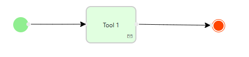

I have a form called allocate lecturer, where the user will select a class and assign a lecturer to that class, currently the system doesn't require the lecturers to have an account in the system so I am fetching their emails from an external API. The process I have only has an email tool. The form uses a JSON API to initiate/start the process, and it's supposed to send an email to the respective lecturer.
Issue

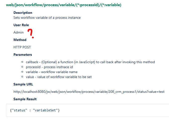

In the email tool, I tried to call the workflow variable as such above, to fetch the lecturer email from the form, but it doesn't seem to work, I am assuming that the way I am trying to get the variable value is incorrect.
I made sure the variable was added to the process also and everything else that is required, but not even the testing email is sending to the respective email.
I tried to use the JSON API that passes variables to the process. I don't think it is working, I assume that is because I logged in as a different role other than "admin"???
Image related > reference.
Below is how I implemented the JSON

      Hello, regarding this issue, you don't need to actually use the "Set Process Variable"  json API, you can just use the start process URL and add the parameters as such:
      In a nutshell, if this is the url
      https://joget-iis-dev.apu.edu.my/jw/web/json/workflow/process/start/${processId}
      You just add parameters
      https://joget-iis-dev.apu.edu.my/jw/web/json/workflow/process/start/${processId}variable=example&variable2=example

      Then in the process you call the stated variable values as such:
      #requestParam.email#
