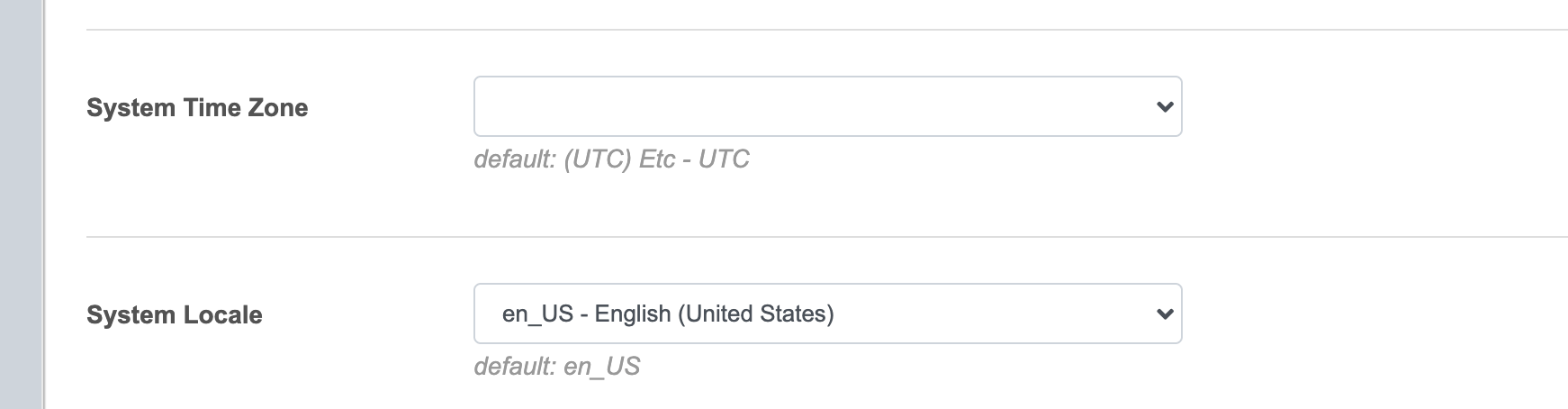

      I found it. Not in System Time Zone in General Settings but in user Time Zone! Thanks for your time.

          I have already tried it but did not work. Have to make a restart of Joget?
