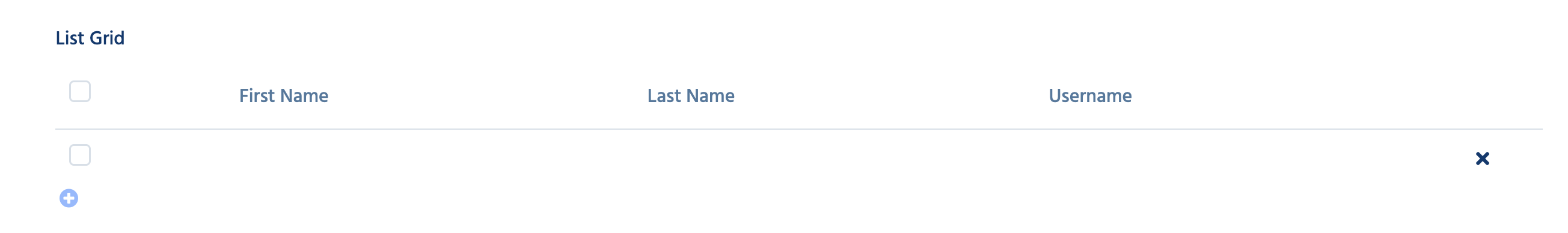

I am currently working on a project which uses list grid to add records from a list. The datastore for the list is set to database wizard and I have selected the correct table and selected certain columns to add to the list. But when I add a new record, the list grid columns does not populate with the selected row's details, instead it is blank as you can see here.
I think this is an issue in how I have set up the list grid, but could not have been to figure out how to fix this.

      Instead of using the Database Wizard to retrieve user data, I switched to  Platform Entity and selected the "User" entity. By doing this, the list grid populated with the selected information.
      This resolved the issue on my end.
