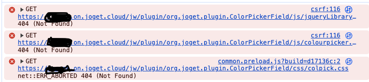

I'm currently developing a custom Joget plugin and running into trouble when trying to load JavaScript and CSS files in my Freemarker template. All the paths are returning 404 errors, and I’m not sure what I’m missing.
Here’s how I’m referencing the files inside my ColorPickerField.ftl:
<script src="${request.contextPath}/plugin/org.joget.plugin.ColorPickerField/js/jqueryLibrary.js"></script>
<script src="${request.contextPath}/plugin/org.joget.plugin.ColorPickerField/js/colourpicker.js"></script>
<link rel="stylesheet" href="${request.contextPath}/plugin/org.joget.plugin.ColorPickerField/css/colpick.css" type="text/css" />

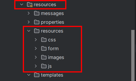

        You need to add another folder "resources" as below

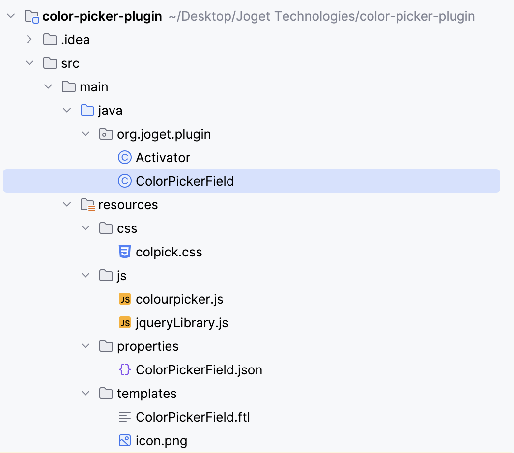

          Please provide your project structure especially inside resources folder and also make sure that the classpath and classname are correct
