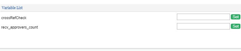

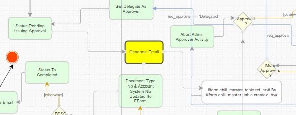

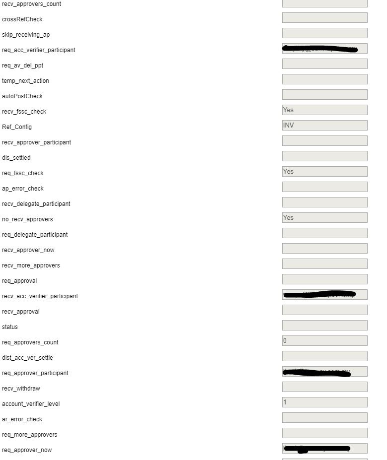

Recently in our app 4/2000 request are stuck on a tool which is an abnormal behavior and new to us. The other part of this issue is that the previous tool or activity executed has all the workflow variables and its values but the one on which its stuck has only a few or none workflow variables.
When click Complete in the monitor of the specific tool or activity it gives some errors.
Attached are the screenshots of the tool stuck and workflow variables scenario with the complete error when click the complete button
this is the tool which is stuck and its status is not started
this is the graph view of the tool where it's stuck
the workflow variables of the tool which is stuck
the workflow variables of the previous activity/tool successfully executed
