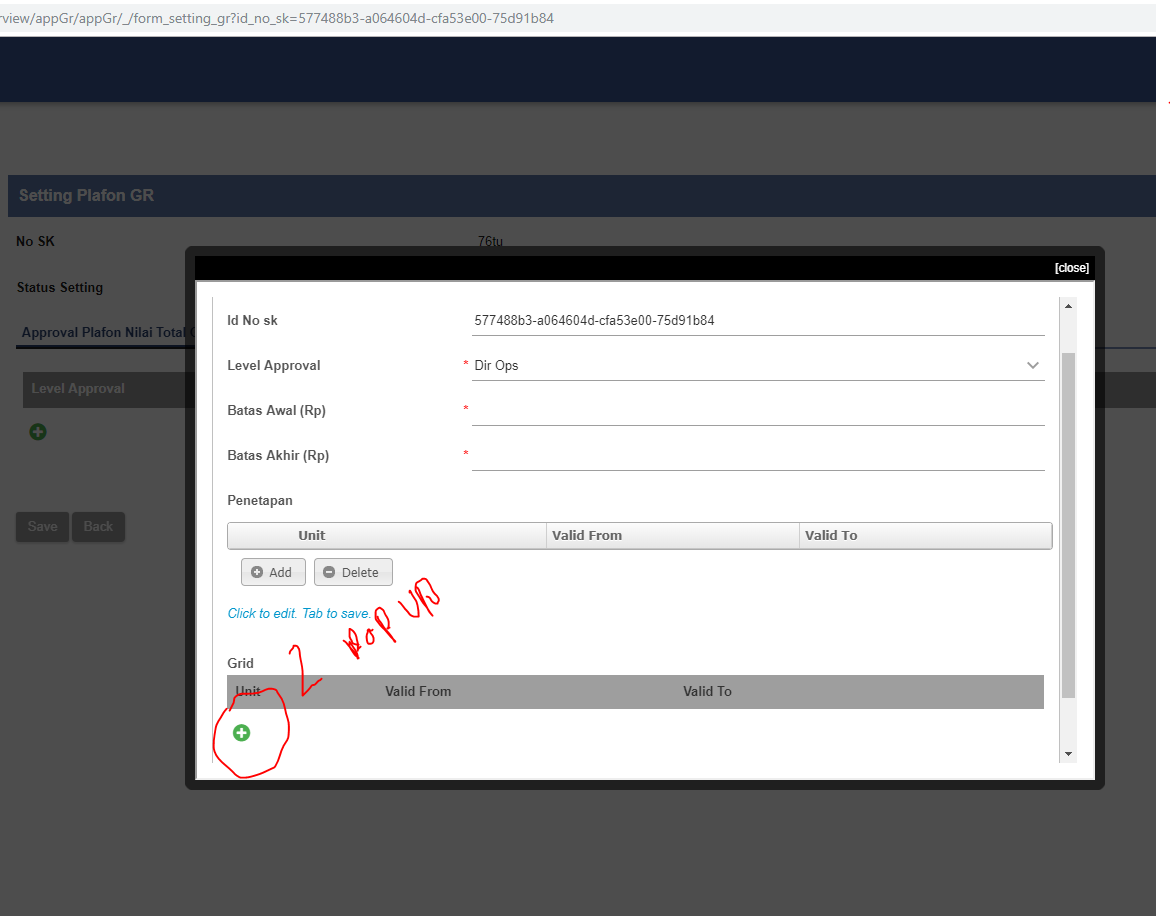

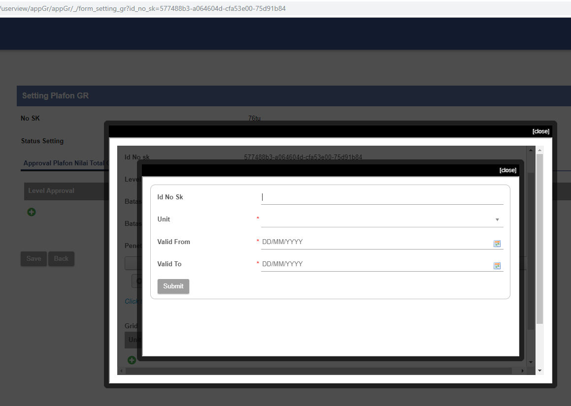

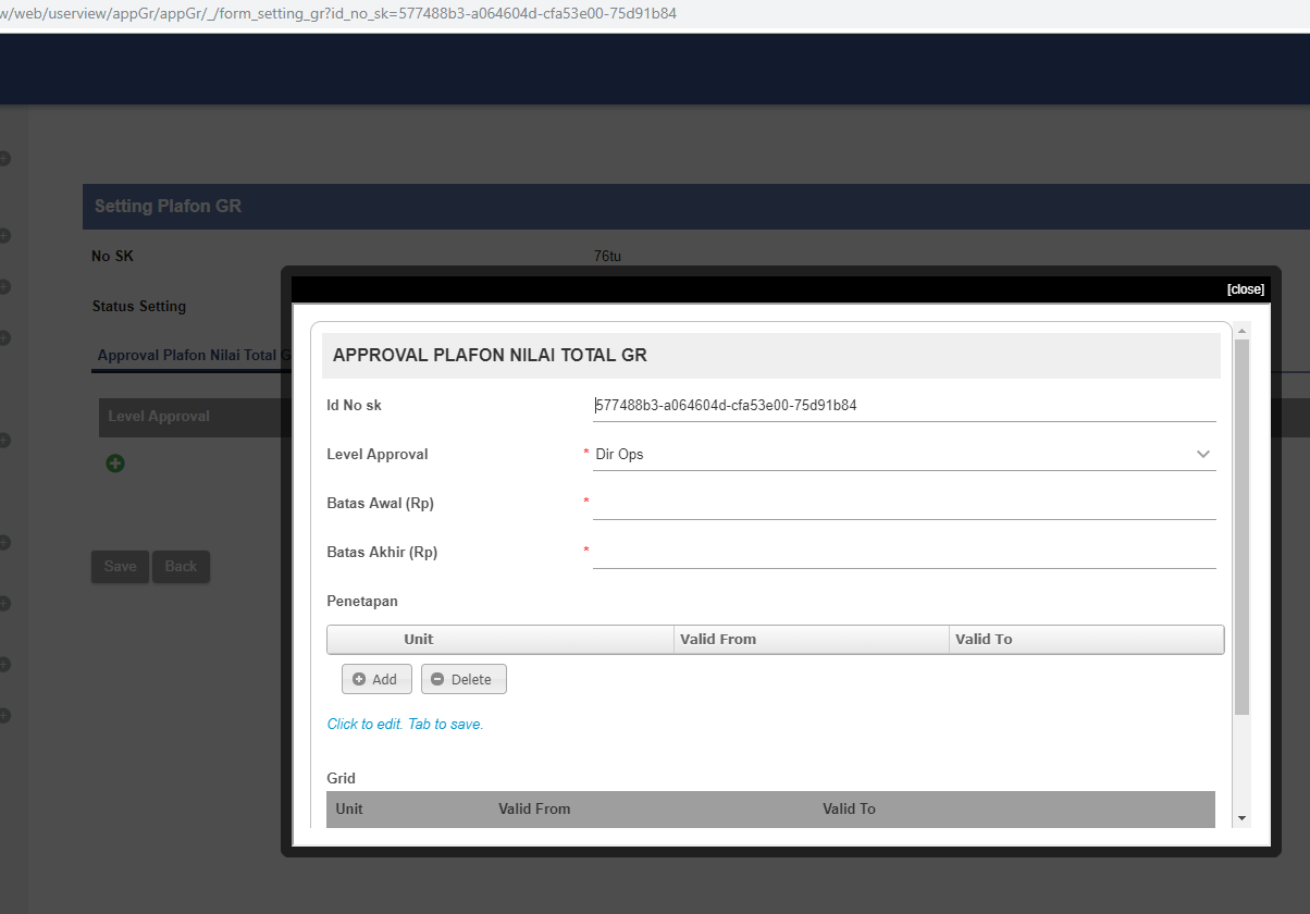

yes, but when i access from embed from embed form that is nothing value
when i access it from popup (first) i have value
but when second popup i get nothing value
please help me

Does the inner popup contain the parameter in the URL? Unlikely, so if you need a value from the other windows you may need to use some custom JavaScript perhaps you can try https://stackoverflow.com/questions/6017796/jquery-select-element-in-parent-window

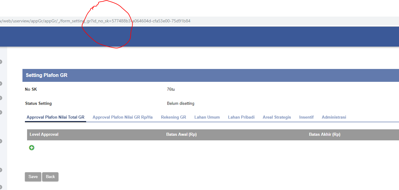

is not using hashvariable?
Hi, is the id_no_sk part of the embed form URL? For the requestParam hash variable to work, you need to ensure that it is actually a request parameter in the URL eg http://domain/path?id_no_sk=value

yes, but when i get from nested form grid i have nothing value

Hi, i have problem to get request param from embed from,
i'm using hash variable #requestParam.id_no_sk# but value is nothing,
