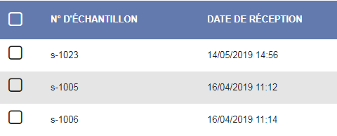

OK Solved.
When using JDBC, it is necessary to use STR_TO_DATE(field, "format") to ensure that the column is a date.
Thanks for the insight Camilo.
Cheers
Hi Camilo, Indeed it is JDBC! I get the point. Because everything is "string" in the database, it cannot know it is a date field. Is there a workaround with JDBC or should i use only form source? Thanks a lot, Baptiste
Hello,
I'm having an issue when sorting a datalist using a date column. The sorting appears not to be considering the datetime to perform a chronological sorting but the string value and performs an alphabetical sorting (hence using only the "day" part in my case).
Am I missing something?
Thanks for the help
Baptiste
Hello, in principle, I think it depends on the format of the value you're putting in the column. The data source of the table is JDBC? or is it directly a form?
