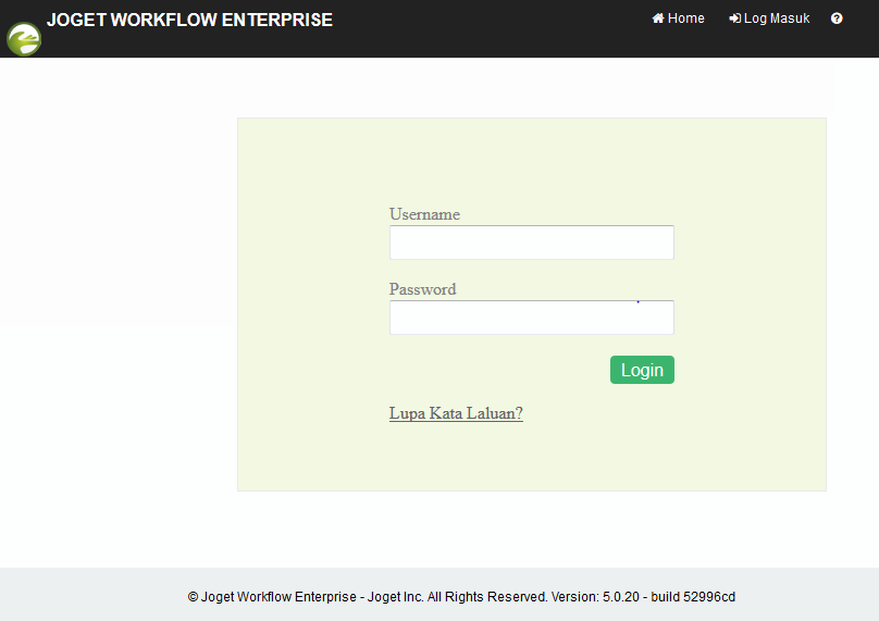

How to avoid user direct to this joget login page when user browse http:<websitename>/jw/web/login .Please see
picture attached. Actualy i already have my mainpage. But sometime people direct to the http:<websitename>/jw/web/login that already in cache.

      Hi Joe Zhou,
      To resolve the issue, head over to Admin Bar > General Settings
      Under User Interface Settings, specify the App's URL in the Landing Page field such as below:
      /userview/appName/v/_/welcome
      Note: "welcome" in the above example is the default Custom ID for the Welcome HTML Page whenever you create your userview.
        Hi, did somebody solve this issue? I have same problem and above solurion does not work.
          Hi, I have got this problem too. Setup landing page seems doesn't resolve this issue. The issue is before a user login, if the user put http://domain.name:8080/jw/web/login directly in the browser address bar, it will open the green login page just like jogetuser mentioned above. On that green login page, at the top right corner click the "Home", it will open the http://domain.name:8080/jw  then finally display the landing page which is what we want, but the URL in the address bar still shows: http://domain.name:8080/jw/web/login.  So in short words:
          when people goto http://domain.name:8080/jw,  good,
          when people goto http://domain.name:8080/jw/web/login directly, will display the green login page, this is what we want to avoid.
          Is there any solution for that?
