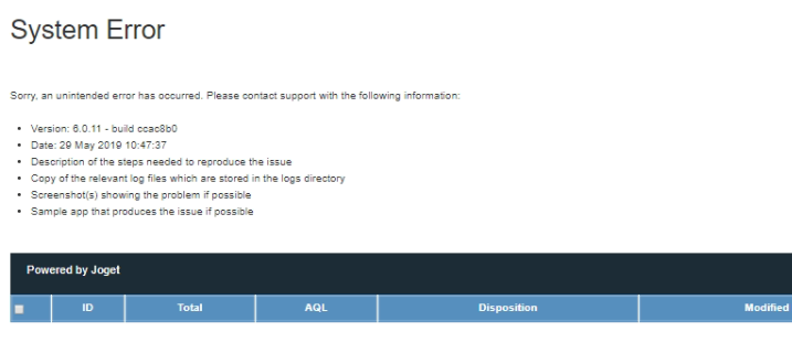

I have error when open a datalist that include datalist formatter. I had import this Apps in 2 different PC and one device is able to view the datalist while the other got this error.
I try to check on the log and get this error:
Caused by: Exception: [.LookupUtil] Error looking up property "column(critical_disposition)" in object type "org.joget.apps.datalist.service.DataListDecorator". Cause: null
